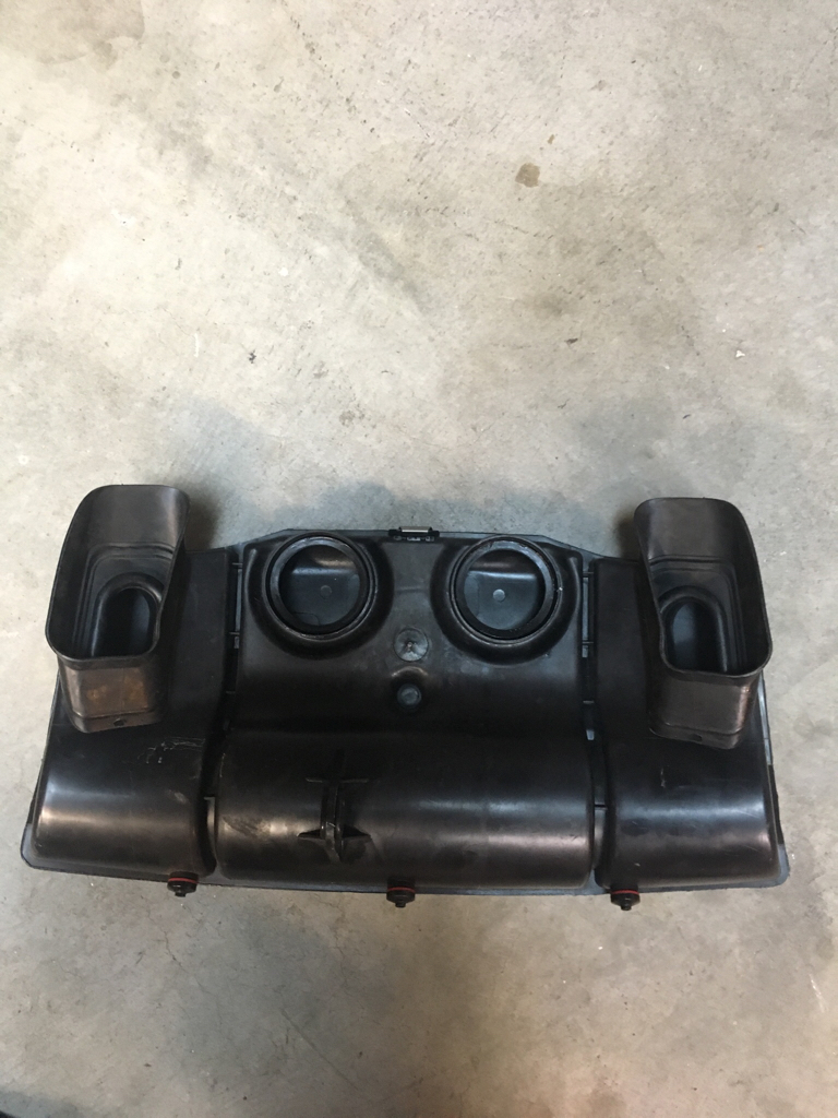

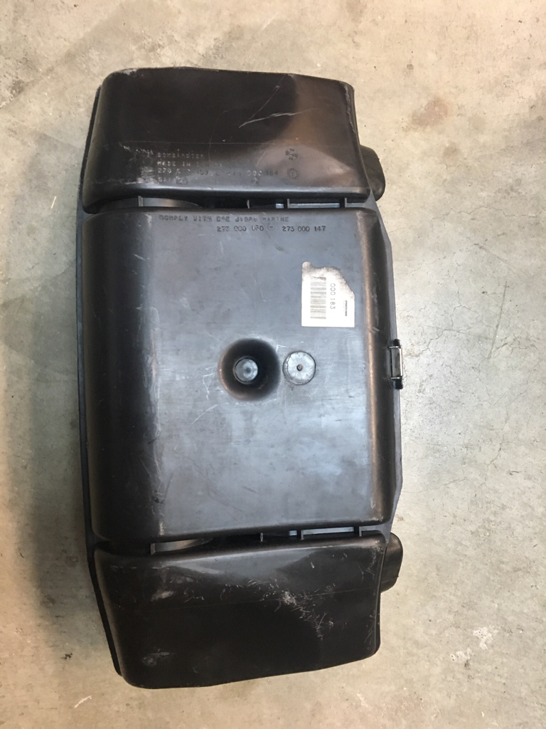

Stock airbox is the best and safest. I actually just pulled one out of my attic to get rid of if you need one. I don’t have the snorkels or flaps though.
Not sure is this is okay to discuss on here but how much would you wanna get for it? Also hows the stock jetting on the 951? And how would it fear with me running premix? Apologies for the abundance of questions.
