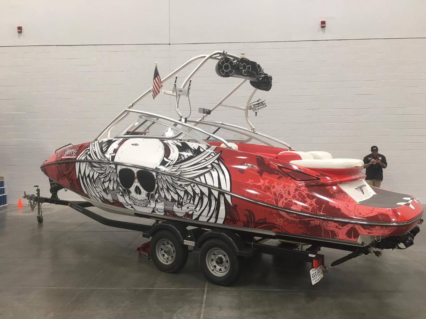

My buddy just got the craziest one you can get. He has a sick 230 Speedster.
