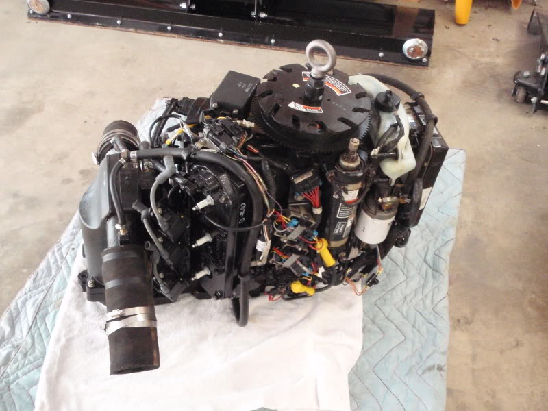

Just an update.
I got the engine out. It was actually easier than getting a typical Rotax engine out. The only issues were the big rubber couplers on the exhaust (they were stuck) and a small cable. I think it's the throttle adder for the steering system... but the connection is up behind the vapor separator.
The one thing that I thought was going to be an issue... turned out to be a non-issue. Originally, I thought I was going to have to remove the massive deck lid... but the way it's designed... the hinges allow it to just be opened into a vertical position once the struts are removed.
Here are a few pics. Can you spot the problem with pic #3???
Congrats on getting the engine out! It's nice when projects go easier than expected. Thanks for updating us on your progress.
And no, I can't spot the problem in picture 3. Maybe if I had a bigger screen I would. Reading the forum in an iPad as of right now.
Close enough !
The correct answer was... "Connecting rods work better inside the engine." (lol)
