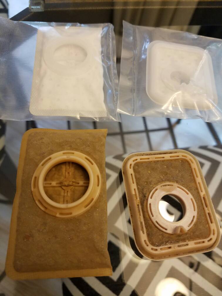

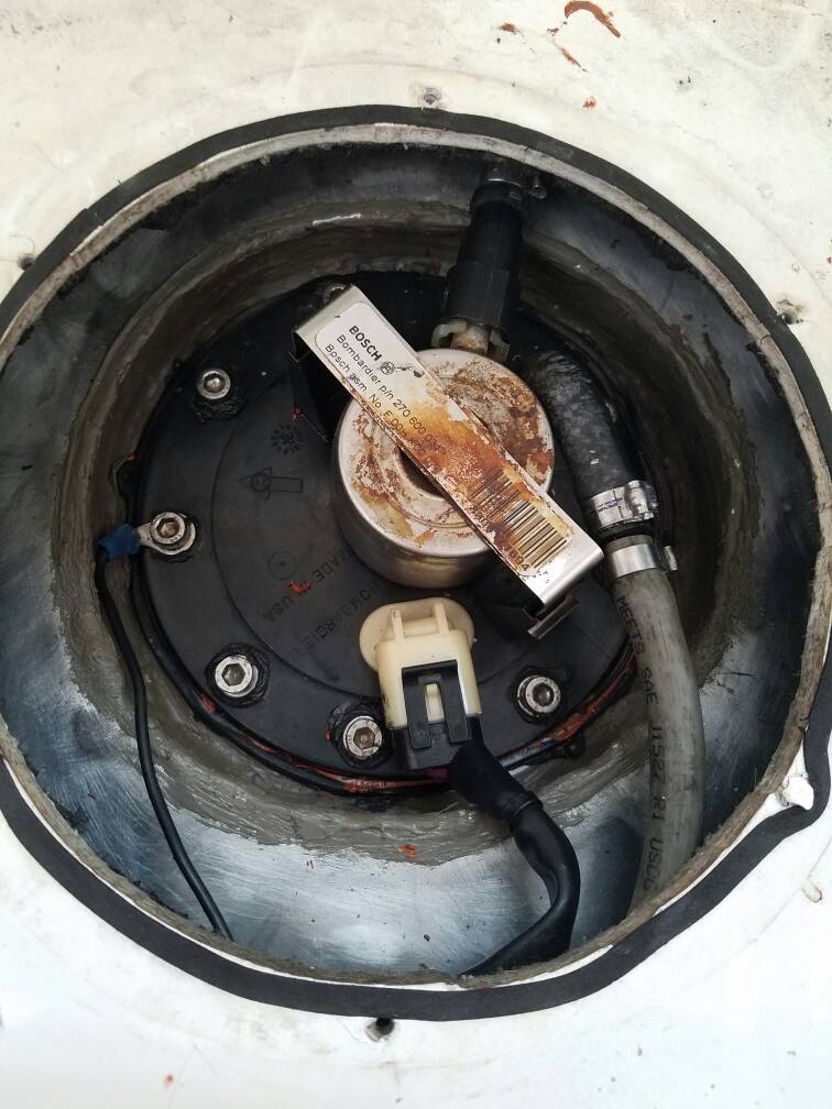

Well, i finally had a chance to install the new fuel pump strainers.
The top, inner one doesn't fit quite as snug as I'd like, but there is another filter before the fuel reaches the rail. Despite the threatening weather, i still made it out to Harris Lake and managed to test the boat with less than half a tank. The bogging problem is completely gone, even with 2 bars going on 1,the hardest turn couldn't make it stall.
While i had the seats off, i decided to install my secondary fuel vent. I took my plug out of the fuel pump vent and tied it in to the main vent using some of that grey fuel line i got off one of my other two stroke skis. No sense wasting good fuel hose on a vent [emoji106] i also had to use the piece of cooling hose with the 90deg bend that i cut off the original coolant hose that attached to the coolant reservoir. Without that bend, a straight hose would be kinked.
