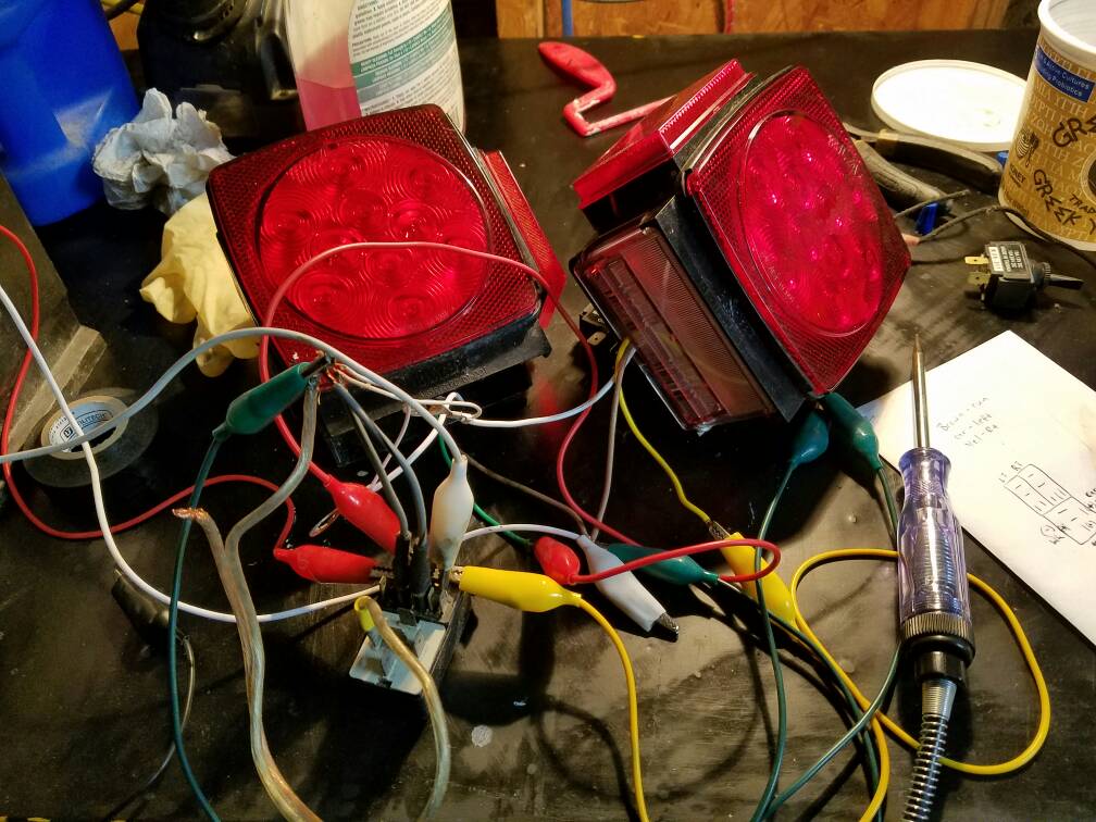

BTW, I'm in the process of wiring up those relays for the trailer lights. It took me a while to realize that the running lights are actually not part of that circuit

Tdi powa! I want to put one in my mk2 but its a GLi and i dont know if i can do that my self. The running lights skip all that but you could add a 4th to pull power from the fused source for stop/turn to take the load off the jettas stock circuit

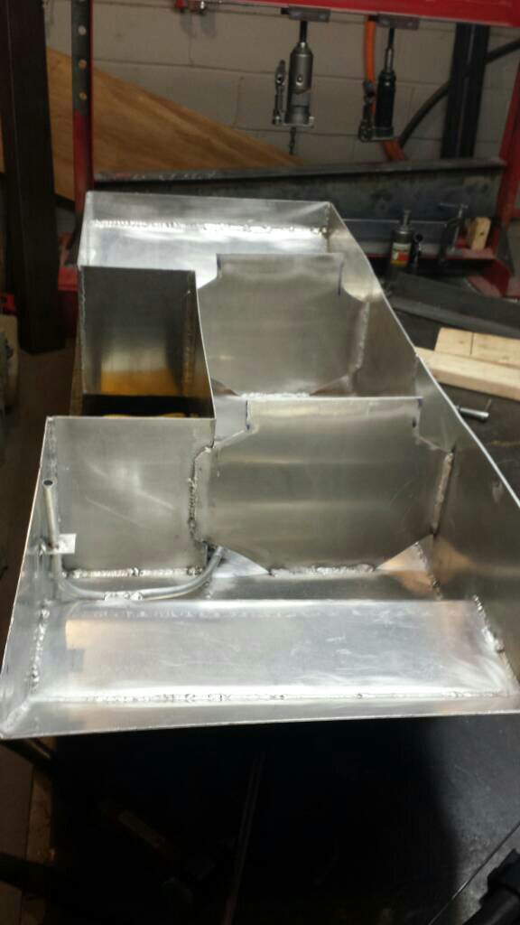

Went out today with my family for a bit of cruising. They haven't been on the boat yet, so I picked today to give them a ride. I had at least half a tank and it started doing that thing where it cuts the RPMs. It's the damnest thing. On Saturday, I invited two friends, and them and the wife rode in it all day, starting with a full tank, and NO PROBLEMS. But when the tank gets to about half way or less, it does this weird engine bog. The rpms fall and fluctuate at around 4k or so. Opening the throttle makes them fall more, so I think it's starving for fuel. Again, if I slow down to idle, it idles fine (well, not perfect, the idle does fluctuate by about 100 rpm but it always does that). After a bit of idling, I can open it back up to WOT and it seems to run fine. I was cruising about 6k rpm when it happened the first time. Then after idling, I was going about 5600-6k and it happened again. Both times seemed to happen after a turn.
Just after it happened, I made sure it wasn't my engine crank case pressure creeping up again. I quickly reached in and cracked open the oil dip stick. No tell-tale hiss, so I think I'm good there. No oil seeping from around the valve cover or anything. I think what's happening is that when I turn, all the fuel is escaping to one side of the tank. I believe I made the holes in the baffles too large. Since it happens at around half tank, the fuel fills up that half of the tank and starves the pump. I believe it introduces bubbles into the line and drops the fuel pressure until they're cleared out. So I'm wondering what my options are in this case. The original tank had no baffles, and this problem never seemed to arise no matter how hard I turned it, and no matter how much fuel was in there. The old engine had carbs though, and now it's fuel injected with an in-tank pump.

I wish I could do that. Unfortunately, regulations forbid a marine fuel tank to have any fittings anywhere but the top of a marine fuel tank. I suppose I could have another tank that has another fuel pump in it, but it would also necessitate a float switch or some other device to transfer fuel from one tank to the other.

I suppose the hole could be at the top with a tube to the bottom that would work juat as well.
No need for a float switch, add a return line to the small tank and have a pump running all the time the engine is running, that will fill the little tank which should never then run try and any excess will just rerun to the tank.
Or what about making your own baffle for the tank ( if there is enough room) a cylinder around the fuel pick up with holes around the outside big enough to let the fuel in but restricting the fuel enough to keep the pickup wet. Large holes at the top so it can fill quick when the tank is above say 1/4 of a tank but little holes at the bottom restricting the fuel on the way out but allowing fuel in if your extremely low.
I have baffles in it already, but the holes in the baffle corners must be too large. The pump already sort of has a baffle around it. Last I checked, it was full of fuel and drained slowly when the pump was lifted out. I think I should probably open the tank back up...
On pg16 there a bunch of pics of the fuel tank and baffles. I wish I listened to my dad when he told me the holes were too big. Live and learn, right?
I might try cutting 4 triangles out of aluminum and creating a clip- in sort of attachment for them. Maybe use another piece of metal and pop rivets to pinch it to the baffle and reduce the hole there...
What about using some of the fuel tank foam?
I have no idea what it costs but I know race cars use it instead of baffles, assuming it's not quick and easy to take the top off the tank you could maybe force the foam into the centre though the gauge hole and that may provide enough resistance.

I thought you already pulled the tank and cut the top off again. You could try a round baffle around the pick up along with the clip in triangles1464787852887.jpg

I thought the aluminum cylinder the pump sits in IS the baffle. There is even a rubber washer at the bottom that looks a lot like a 1way valve. I'm going to take it apart the next time I get a free afternoon and am not using it
Could be, from random fotos on the webz it looks like it has horizontal slots in the bottom where it slurps it up. Does yer pickup reach the bottom of your custom tank
Oh ya, if you look on pg 16 there are tons of pics of the tank. It has a whole trough for the pump. Same as the stock tank. It didn't even have baffles which baffles me huk huk huk

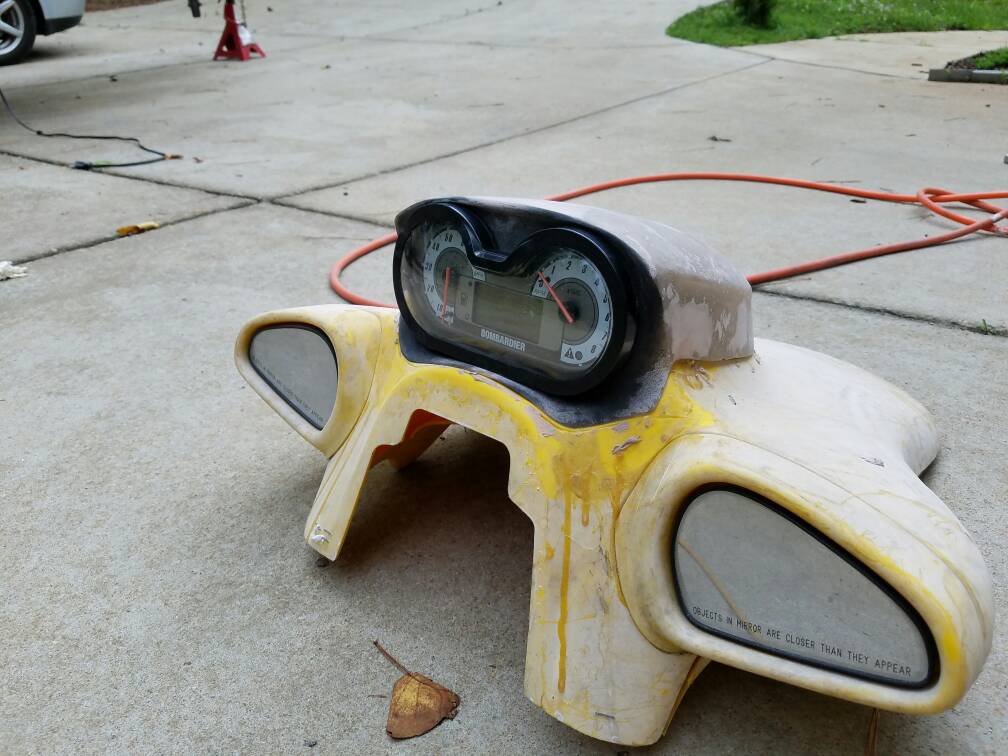

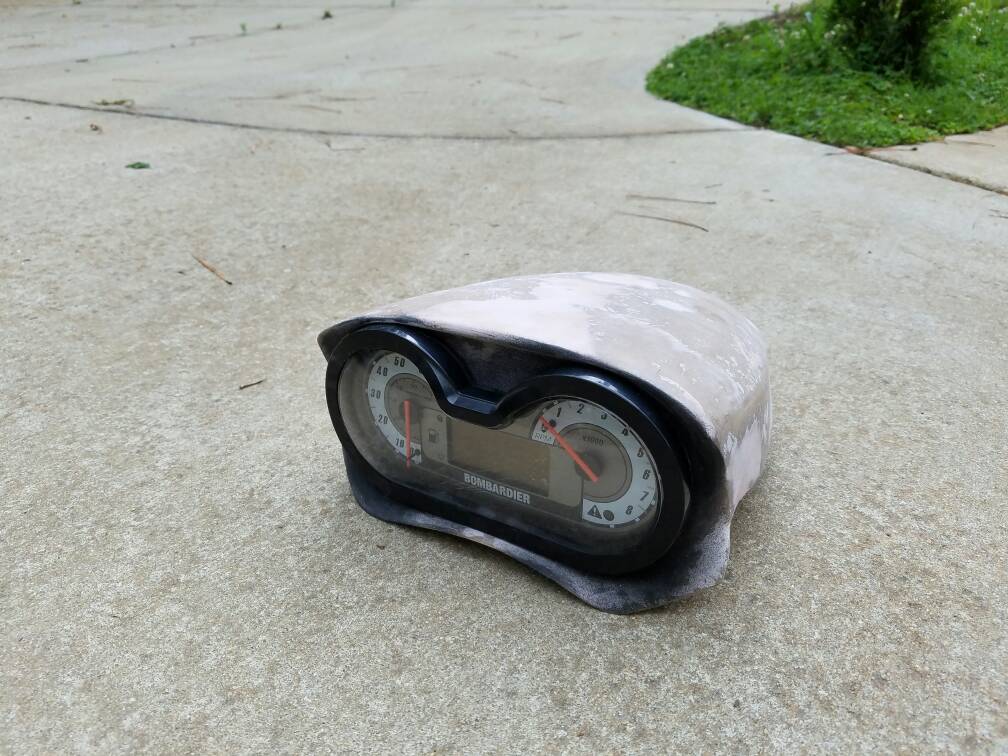

I did get some progress on the gauge pod. That duct tape job is shamefully ugly and is the last thing keeping this boat from being picture-worthy.
I'm currently building an extended visor for it and will install led lights to illuminate it at night
