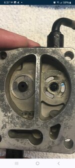

For me it is really hard to determine what side the marker is on so with a little brake clean it rubs off and you can put that side up.
The clear film been in carb pump side for about 35 minutes run time, do you think that I can open up, without tearing the film, and maybe mark, still on film. Do not want to order another complete rebuild kit
I can see the blue marks in your picture.
Put a drop of brake cleaner on a paper towel and see if the mark rubs off. If it rubs off they are installed correctly if not they are upside down.
No, that your Pic, from your carburetor rebuilt feed, I don't have a visible marks, I thought that they marked them, is because they are stamped out from a roll, so they will lay flat, otherwise I am screwed
