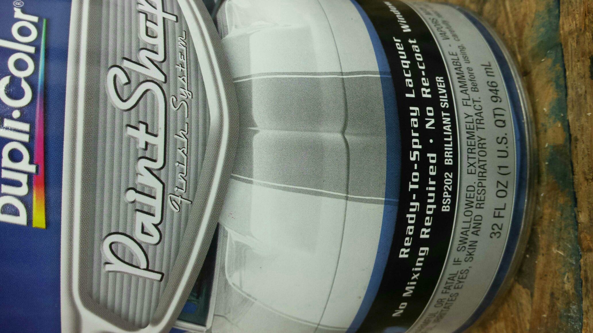

Lol sorry man I'm going as fast as I can with the wife kid work and it's hockey season ....I'll post some more that I get done tomorrow. Working on finishing up the sponsons now and waiting for the base gasket to come in. But I did pick this up today for you lol
Silver it is, I just this base color and then use good clear
