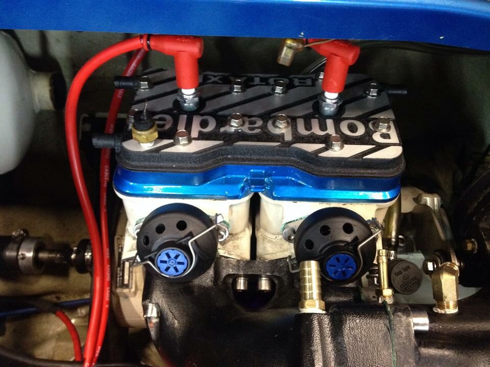

I just used my scotch brite pads on my grinder to remove the paint. I did sandblast my other head and I think I would do the same thing again but before I clear it use a block and sand it

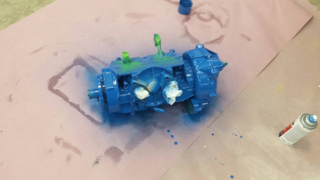

Well got the bottom end back together this weekend and just got it paint.

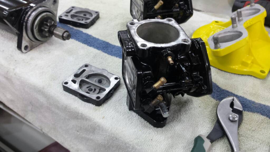

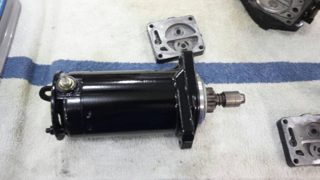

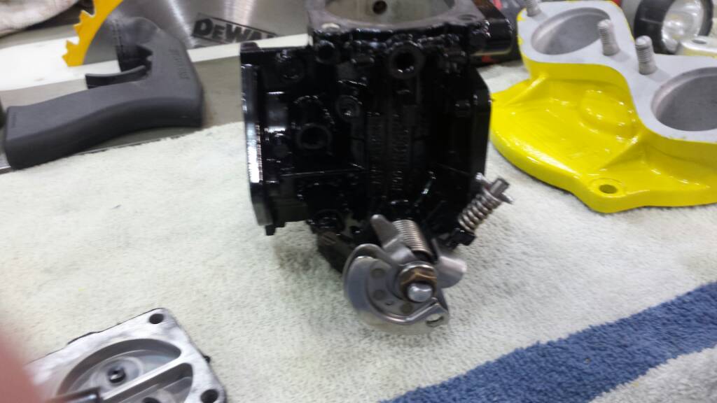

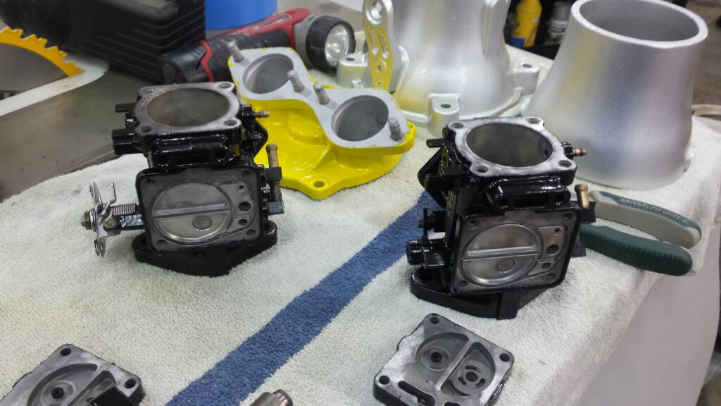

Well some more I got done over the weekend. Took the carbs apart and used the air craft striper on them and then taped it all up and painted it. Also did the starter why I was at it.
when my buddy removed the paint on the raised part, it was polished to a mirror shine, (belt sander, much lower grit)

Thanks matt, Started to get the carbs back together last night and man it took forever to get the pop off set but its all done now lol

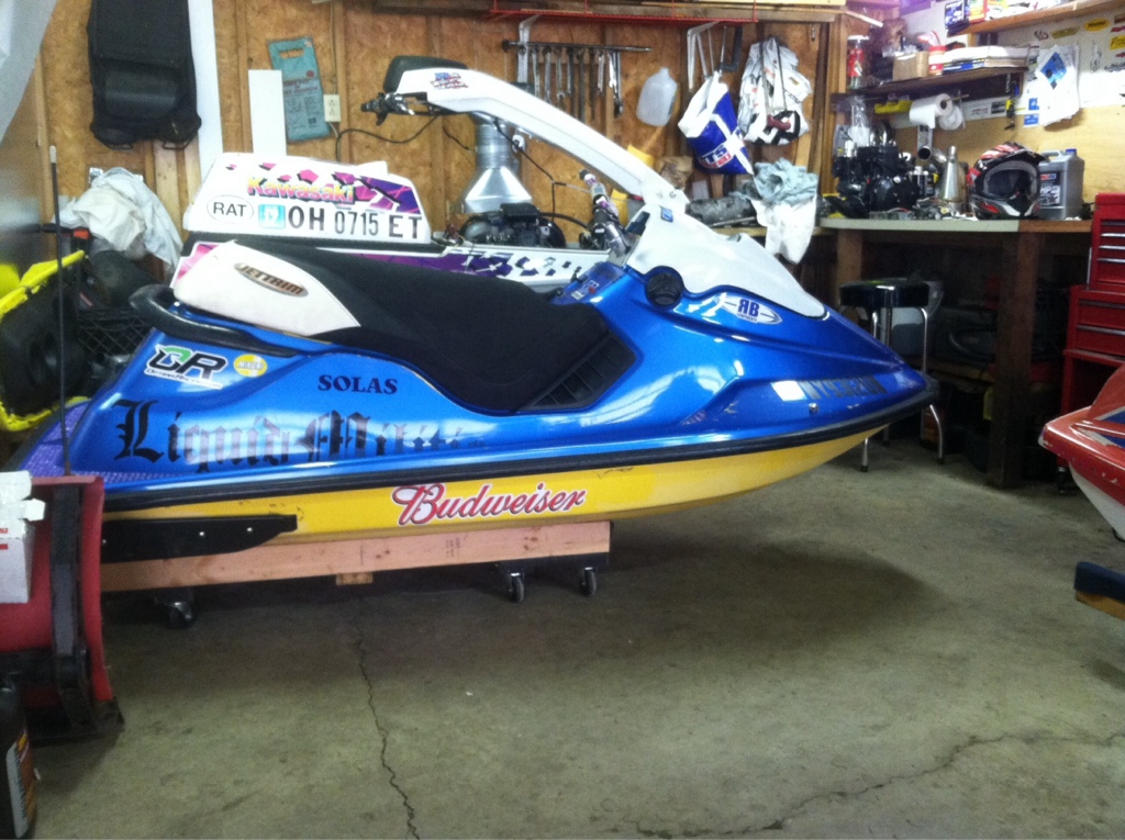

I would rethink the blue/yellow. It's ugly as sin.

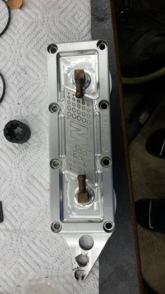

And I think this is what you were going for with the head cover. I have a 1/2" thick plate of glass with emery cloth bonded to it to surface gasket mating surfaces. This took a little while to do.
I ended up going black on the bottom and it's so much cleaner.
thanks for the input, not 100% sure, i could still do silver. To me though I think you should of used some yellow on the top. Kinda like you didnt make it flow together. It does look better with black on bottom now but you also have a black seat and mats
