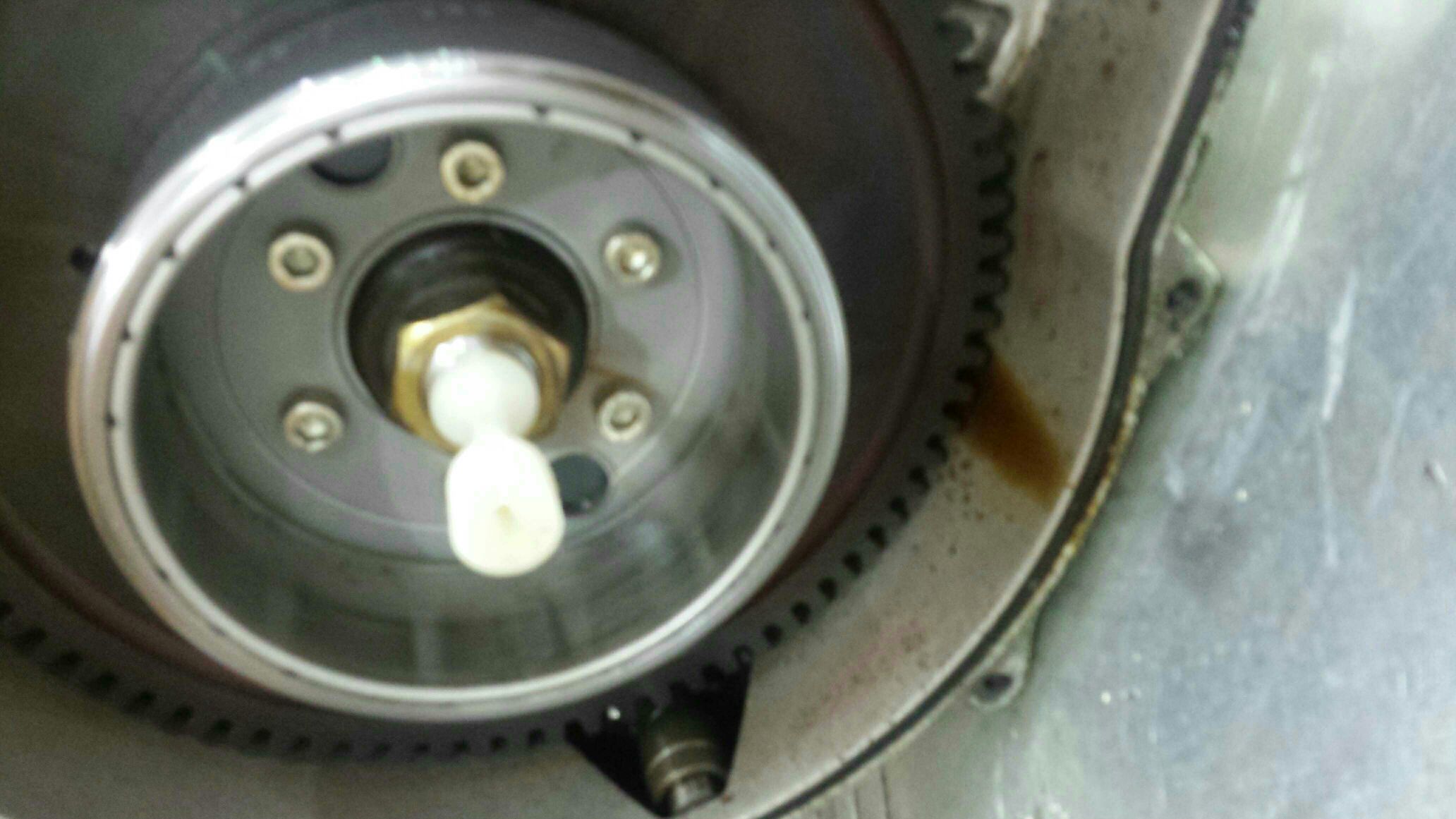

Do I need to split the case?
Nope, just remove the flywheel, the 10 screws behind than and slip the mag housing off, clean the gaskets, bang the old seal out (what would be towards the crank) and carefully pop the new one in.
