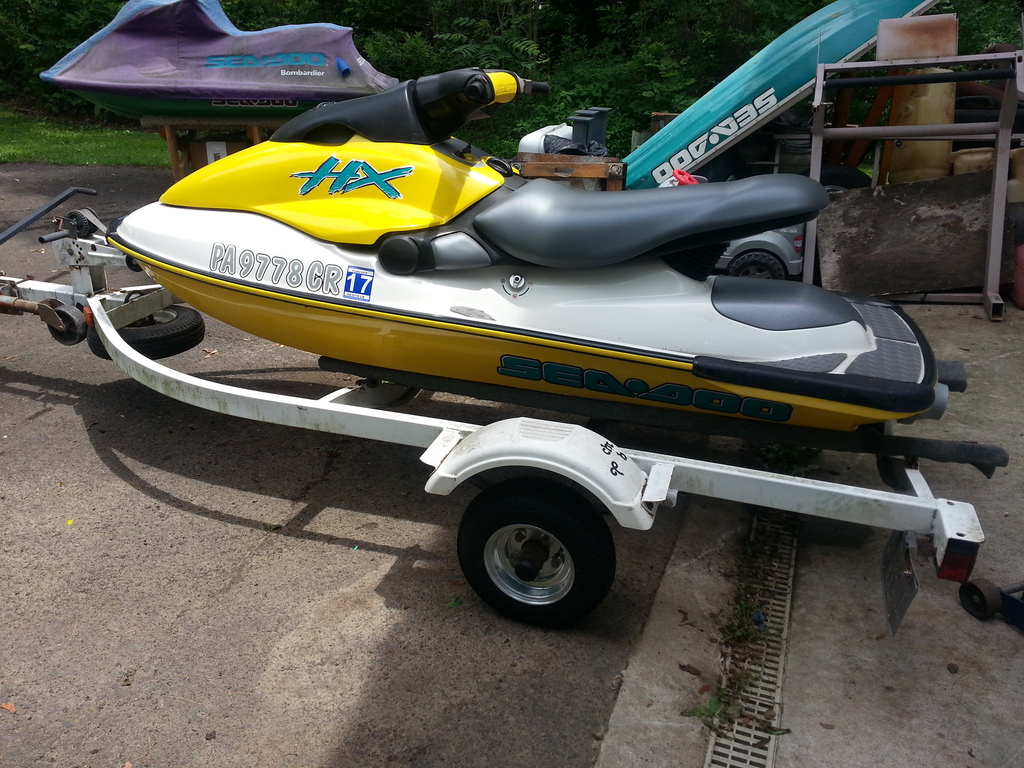

Ok, here's an update.

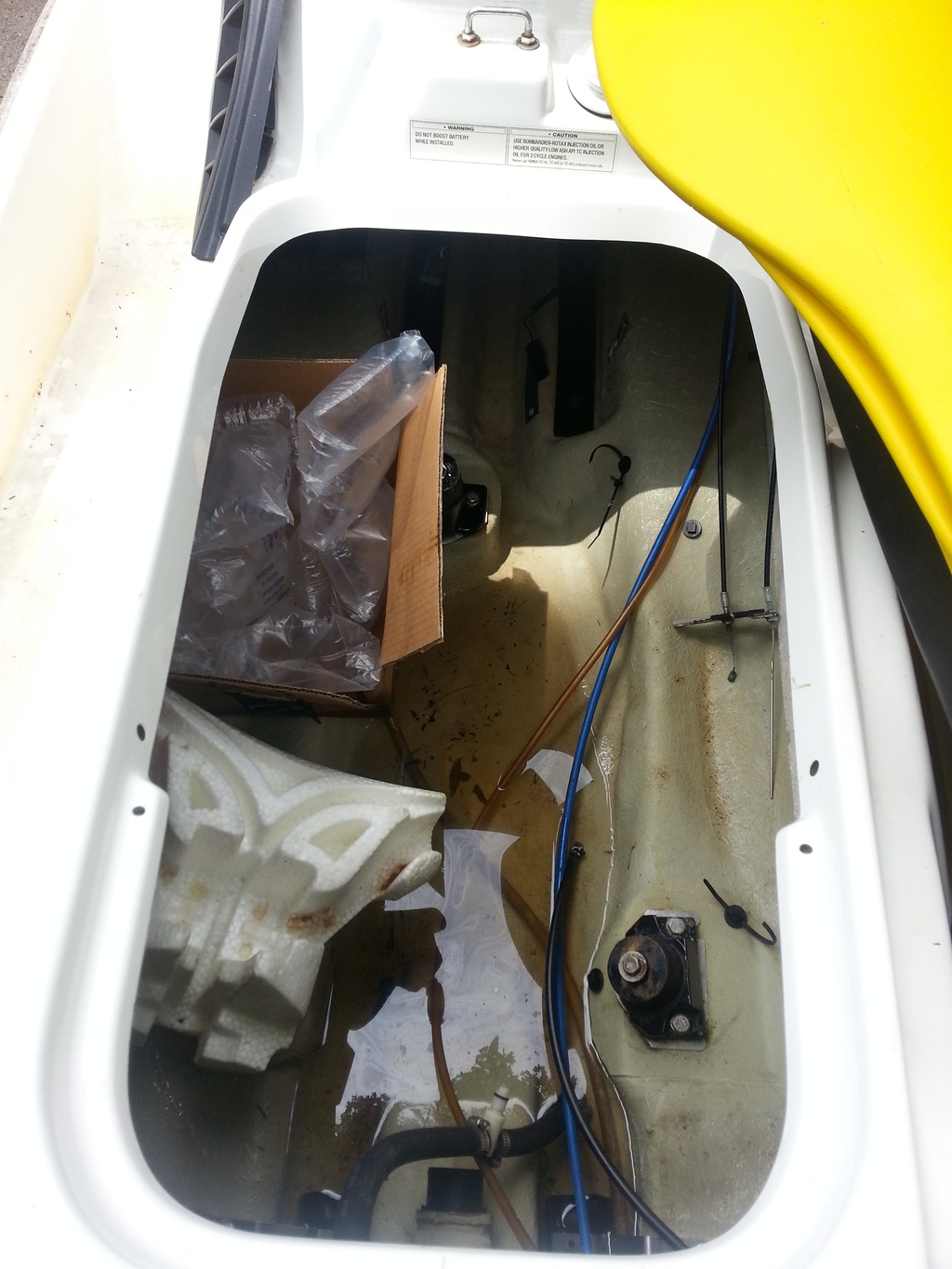

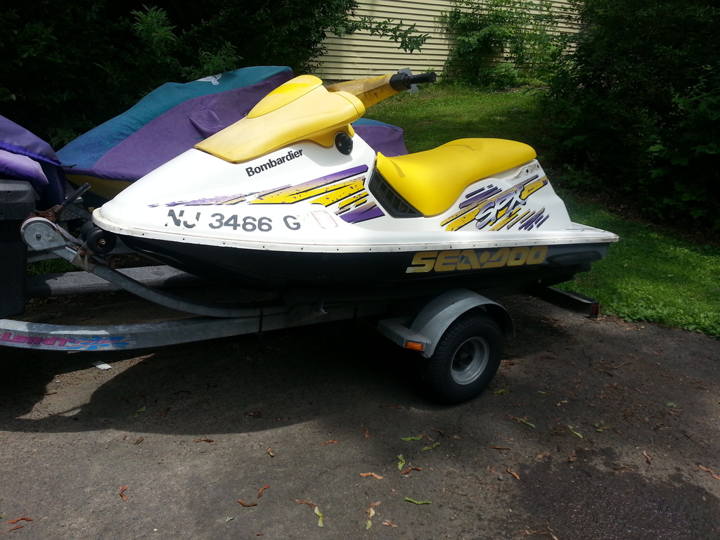

This is how it sits, untouched and empty. I want to take it on vacation SOON. So, I know I'm crazy for trying but I want to see how efficiently I can get it back running. No engine, nor is it assembled yet, head pipe just got picked up from the welders(dropped it off at 11 am, wife just snagged it), carbs are fully rebuilt as of last night. I have a chit load to bead blast and paint yet. [MENTION=2]hfgreg[/MENTION] at
www.PWCMuscle.com got the order for the RacerXXX Edition hydro-turf, black and yellow diamond cut w/o logos and that should be delivered tomorrow. Gonna have to swipe some parts from the 95 to fill the bill on this one and just re-order later for that ski, LOL. Rob Peter to pay Paul! Oh man, I still have to make this legal in my name yet, just remembered that one.

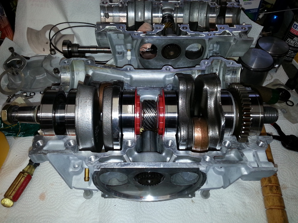

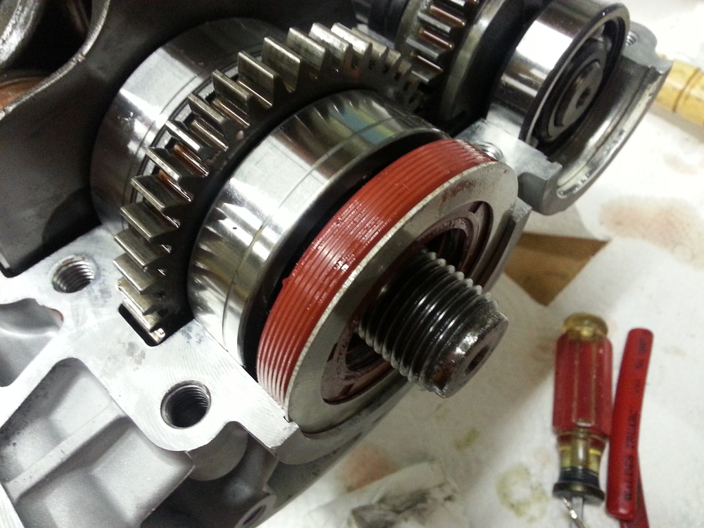

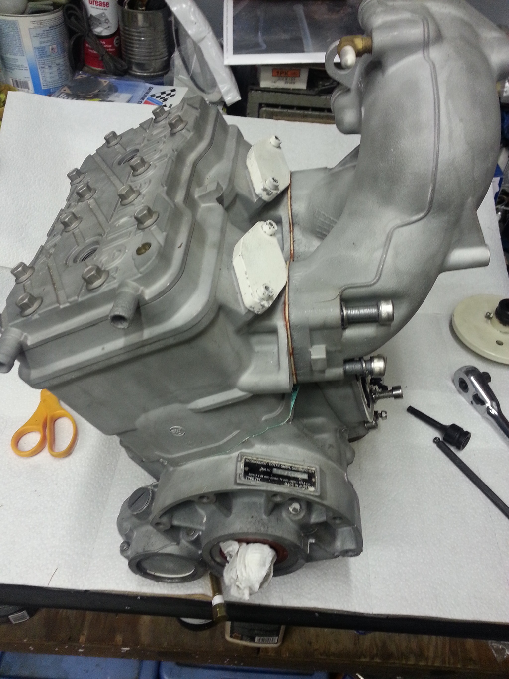

The engine from the 95, it has a 96+ crank in it that I need for the 98 build. I have a correct 95 only crank to put back in the 95 engine. So last night I broke down the 95 engine completely, just for the crank and counter balance.

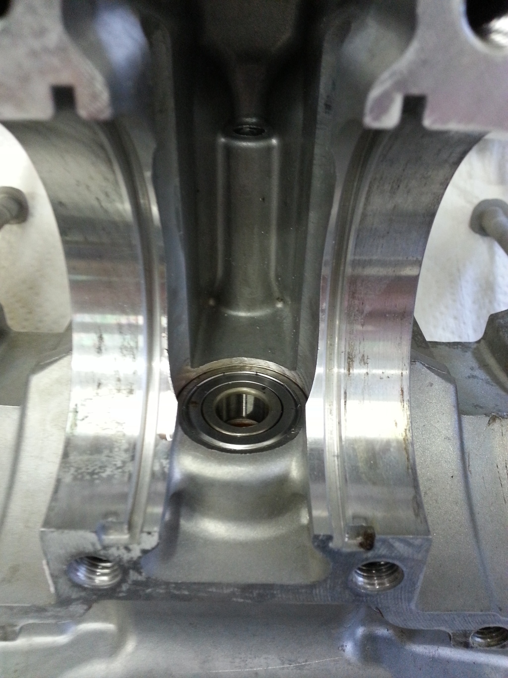

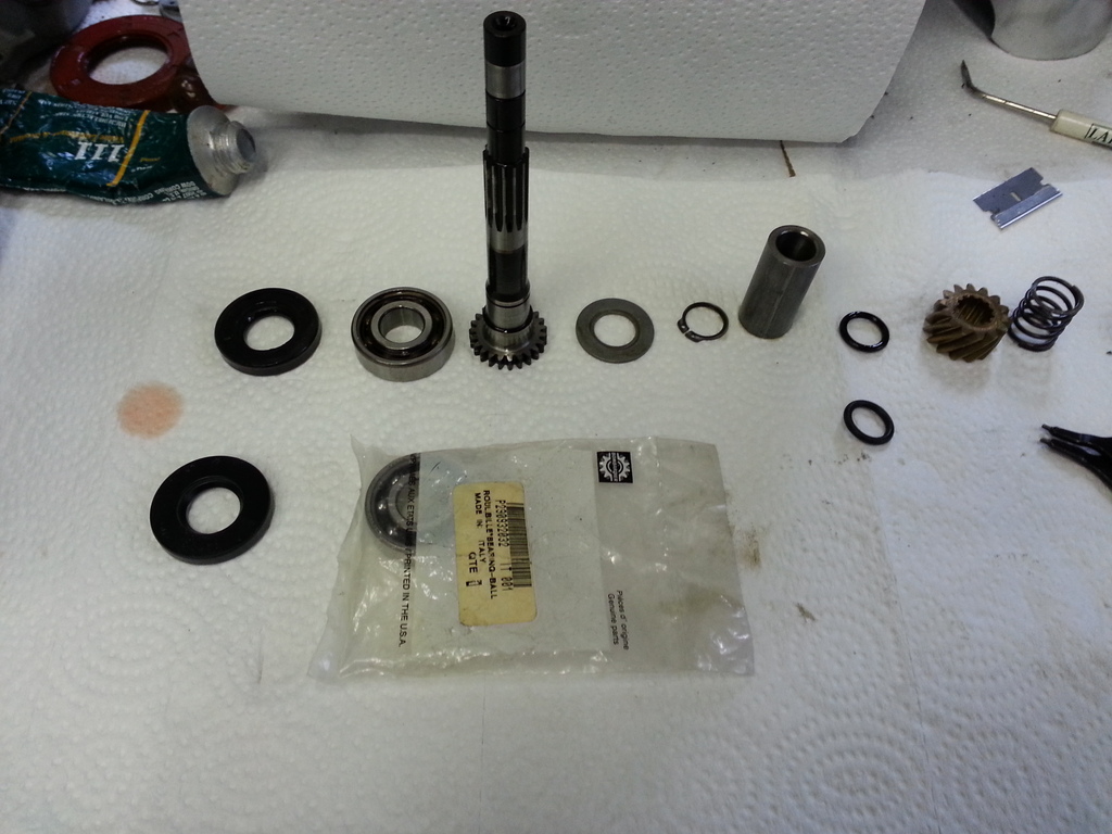

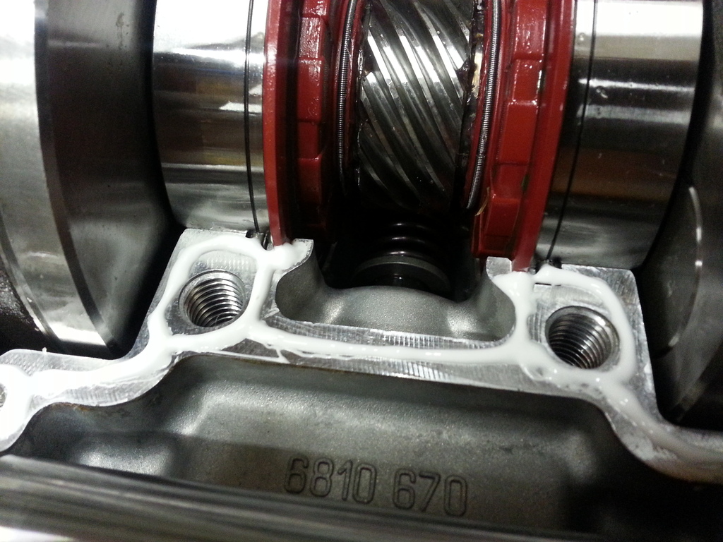

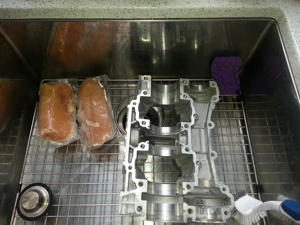

Another set of cases I prepped for the 98, they were 95 only cases from [MENTION=51824]Matt Braley[/MENTION] (where I got the crank for the 95), they were good clean cases. I bead blasted them and am rebuilding the rotary shaft. Gotta do some case prep. Washing them in the parts washer, just took the pics about 15 minutes ago. (Don't mind my dinner, mmmmmm jerk chicken) Oh, and I quickly did the oil fill/drain mod yesterday at the shop.
