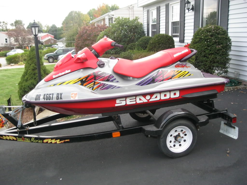

When I purchased my ski, I got the exact same one you just got...with the exact same trailer I see in your pics...from Ohio.

As I mentioned before, I bought the same ski sitting on an identical trailer as you. Here is a pic of my ski.
