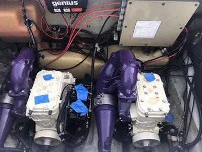

Man I'm almost gettin excited. All the big stuff is in place carbs hooked up, oil injection primed. Just hook up a few cooling water lines (the easy ones :) ) adjust linkages and it's time for tweakin.

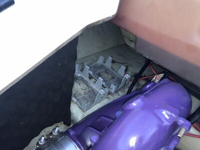

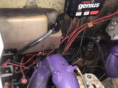

I'm looking at converting from 2 batteries to one large battery. I can't find anything on the forum so far in my searches.

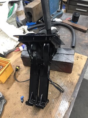

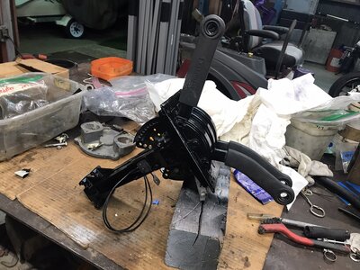

This poor boat should thank me egregiously. What a pile of junk it was. Coming along though just so much stuff needs lots of attention. I pulled the throttle/shift quadrant and got it looking nice. When I install it I'll be able to do some proper adjusting on the cables. I took a picture of the dual battery holders. Engines are almost done. Closin in on mechanical completion. :) Still a lot of cosmetic choices to make. If I was keeping it I'd strip all the decals and turf and replace it. Too much $$ though for a boat I'm restoring.

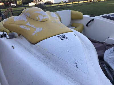

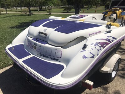

I actually made some headway today. I don't like that the throttle for the left engine is too easy to move for my liking. I'm gonna ready up on that and see if there is an adjustment I can make. Doesn't look like it. Reverse cables adjusted. I'm hoping the electrical works. When I got the boat the left engine wasn't getting fire and I believe it was the MPEM so I picked up another one for a good price. I hope it works. :D

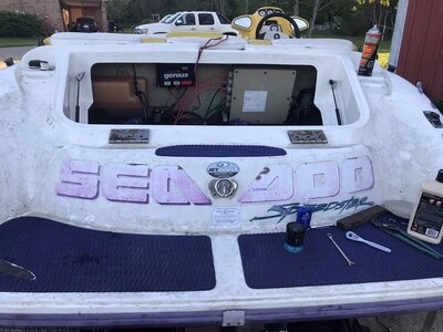

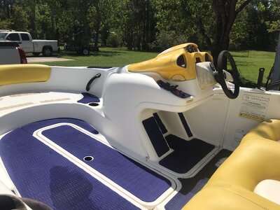

I think the Speedster is finally worth a couple of bucks. :D Before you get everything put together it's just a pile of junk. At least now it is together. Batteries are in and connected but the spark plug wires for the engine are too short. I gotta see what I'm going to do about that. I need to program the key and see if the MPEM is good. I took it to the carwash and spent sometime making it look spiffy. I needs some cosmetic love but for now we're going with mechanical functionality.
I need a latch for the ski locker and I wondering where I can get new cupholders. I need to paint the hood or replace it. I'll probably remove the s decals on the back of the boat as they are really faded.
I doubt I have the grounds connected the way they were but I didn't have a picture. I looked a bit at the manual but didn't see anything. I know I got good grounds though so I'm done. If anyone has info or pictures of how the ground connect and where I'd like to see them.

I’ve seen lots of people making those hoods look like new with 50 percent linseed oil and 50 percent mineral spirits I think. Apparently it’s a long term fix, not like the hair dryer trick. If your interested I can find the exact process

The double battery set up and the engine grounds. I don't remember taking pictures and I didn't see a definitive procedure or connection points. I put the grounds on the Starter which is my preference. Then the ground goes to the gray box. There are 2 ground wires coming out of that box. Then I had 3 more ground wires (different lengths) :D So what I did was....
I made double connections for the grounds (put two cables on the same battery bolt) Then I connected 2 cables to each starter One from the battery and the other to the gray box. Basically I have a double loop of ground to each battery. Overkill I'm sure. :D

I would have to post on another site but my memory says 50 percent boiled linseed oil ( you don’t actually boil it, that’s just the name ) and 50 percent mineral spirits, rub that on with a scotchbrite pad, I think what your actually doing is taking a layer of the plastic off. Have to use tour judgment on how long and how agressive to work it, then go over it with a plastic protectant like back to black. I have had success with scotchbrite paf and barkeepers friend, the liquid gel.
