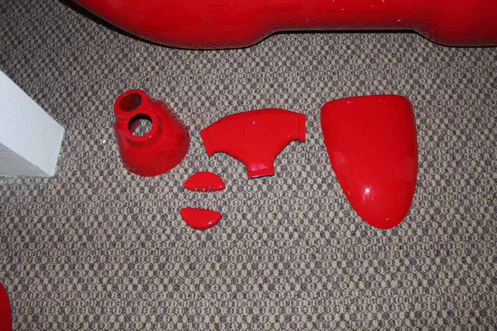

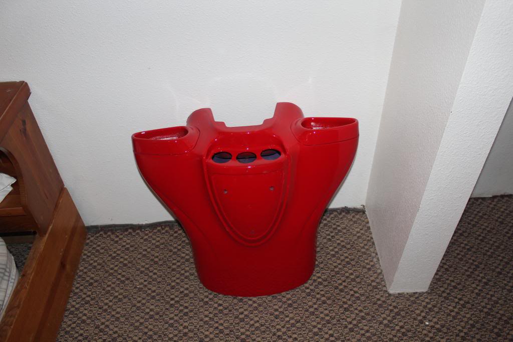

as you can see I got my boat parts back from the shop yesterday they look great
I also have one engine done total rebuild
I have parts on order just waiting for them to showup
