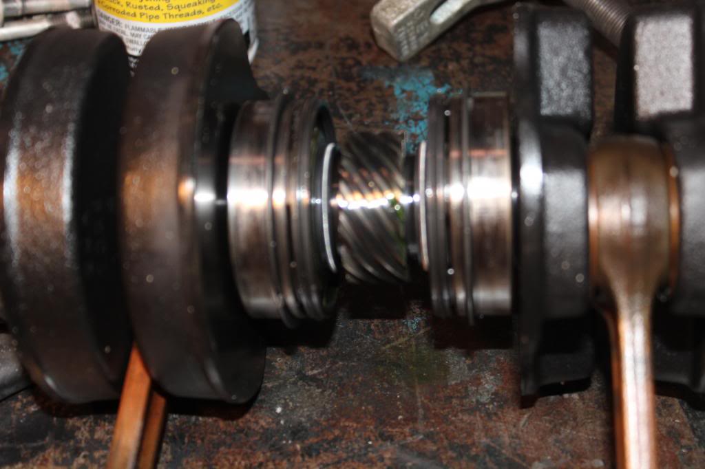

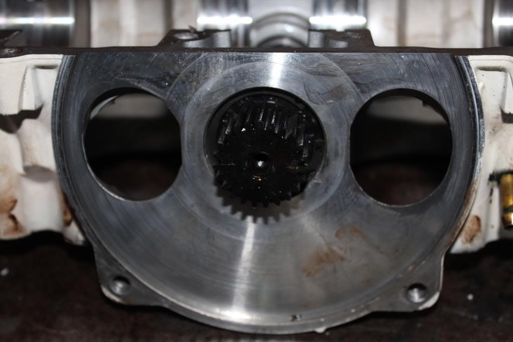

I took the right engine and jet pump out today and I have problems with that engine-my camera is dead but im charging it now as I type-
my pistons are scuffed so im doing a topend bore with new pistons on this engine for sure.

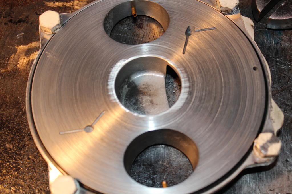

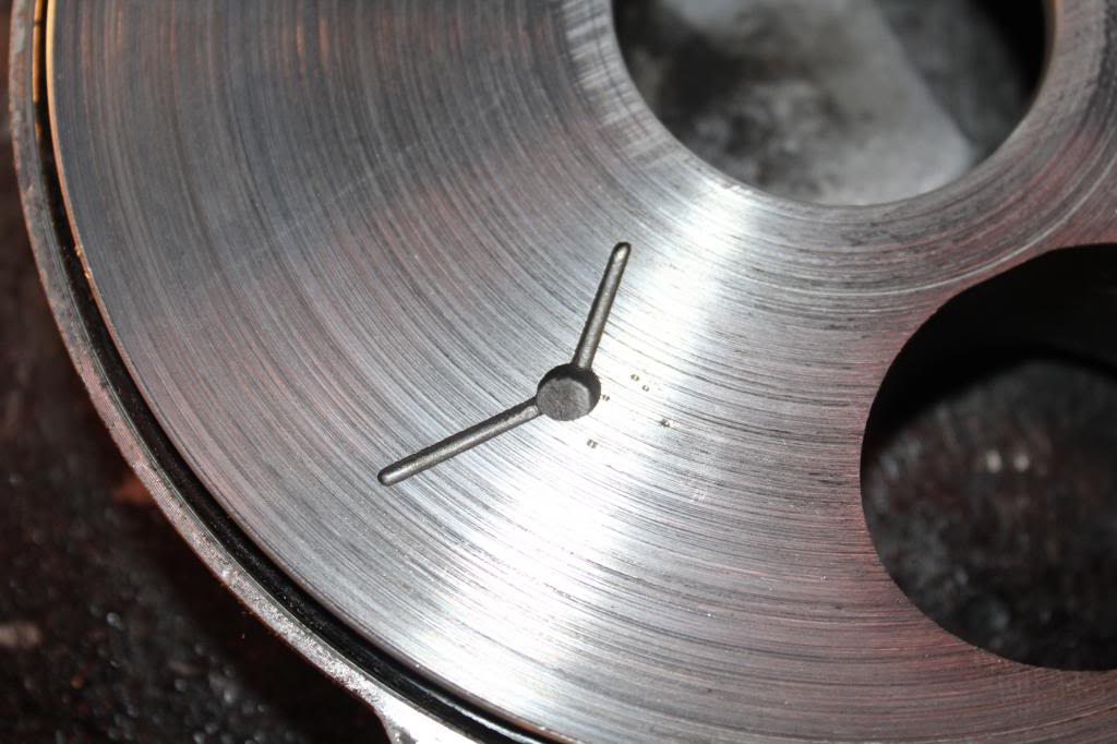

I need you guys to look at my rotary valve and tell me if its ok to reuse?
I also wanted to ask you can I reuse the crankshaft if it checks out on side to side clearance on the lower rod?
I can replace the outer crank seals but I cant replace the inners-the crankshaft was not leaking from the inner seals so would I be good to reuse it with new outer seals?
I will post pictures of everything in the morning
this was the engine with the lowest compression the other engine had 145-150 so im hoping its a lot better shape
guys if I put this thing together and have the innerseals start leaking that would suck let me know what you think
toolanddiemaker I don't think I need them im going to buy new ones to I thank you for offering though
if I can reuse the crank I will bore
if I cant reuse the crankshaft,a new rebuilt engine would be the better way to go
pictures will be posted in the morning
thanks everybody
here are the pictures
the crankshaft looks to be in good shape have not checked the clearance on it yet but seems to be good no up and down on the rods
thanks for the help everybody

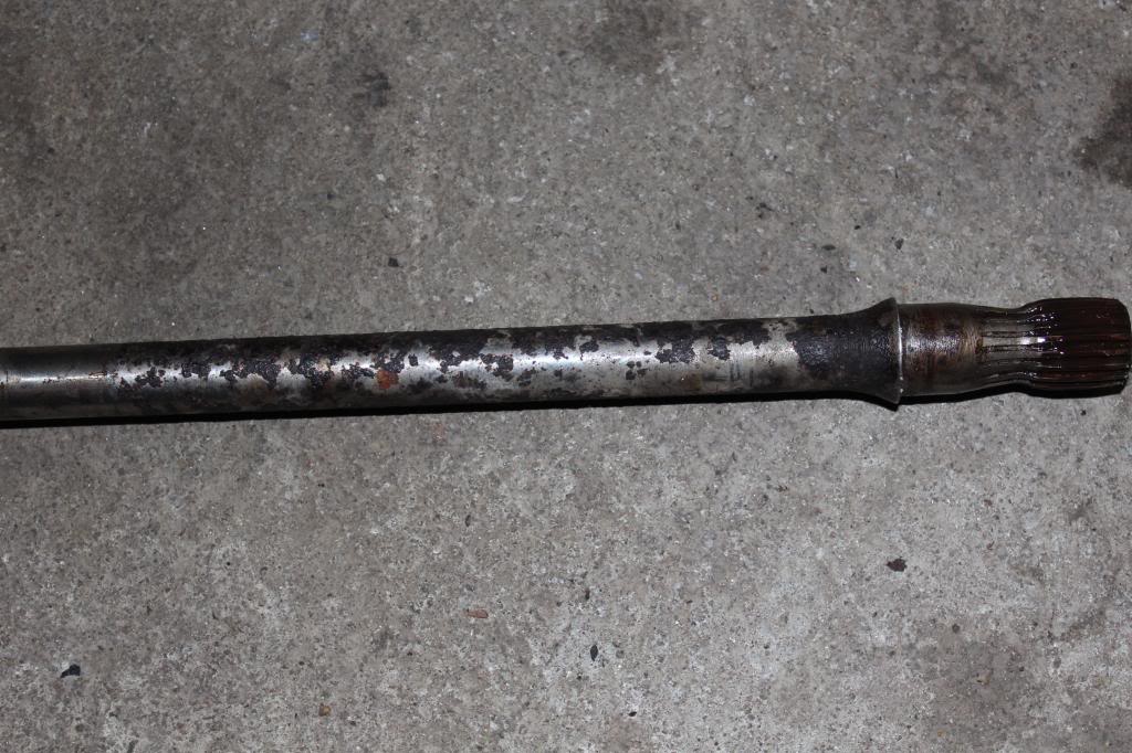

well I was going to rebuild the jet pump and put a new wear ring in that I have and the pump is almost perfect shape im getting a feeler gauge reading of .014-.015 between the prop and wear ring.
I took it apart and all bearing look brand new shaft is oiled real good to.
I think somebody already rebuilt this jet for 1995 it should show a lot more wear than what im finding.
I don't know if I should rebuild it anyway or just let it ride?
Sounds pretty good, I think I'd save the parts for later on down the road for after you've sucked up rocks and sand.
Yea I would let it ride ,you might want to do a pressure test on the pump when you get your new cone its supper easy and will give you a piece of mind.
