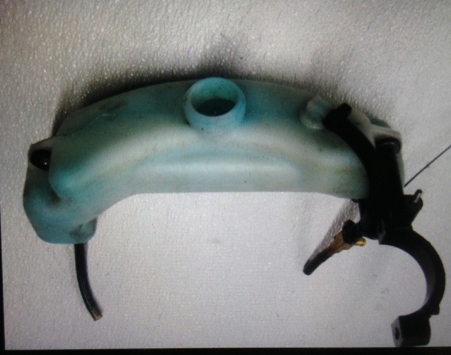

yes loodoo that is what he did im looking everywhere for a oil reservoir right now haven't comup with one yet-so what im going to do is switch the power steering one from moter to moter and only run 1 at a time till I get both hooked up right.
I have also been thinking about buying another power steering reservoir and making brackets to mount them for both engines,but I will try to find the right one for a couple weeks and see what happens.

Might give OSD parts a try:
http://osdparts.com/index.php?main_page=product_info&cPath=1&products_id=7502

I thought maybe I put the lower one on to tight but no it was fine I cant get this lid on for nothing-I have even tried both neither seems to fit right and they where on their when I got it.
eBay had a 2000 Speedster for $24.99. Maybe it will do what you need. There is a good picture of it.
yes I saw that one but it looks really small im going to see if I can find the oem first im looking on ebay everyday and emailing supplyers right now,they should all get back to me on Monday I hope.
I would like to have the oem so everything looks right in the engine bay it will be pre-mixing fuel though so I will only use it for lower oiling.
I just want everything to look nice and neat
