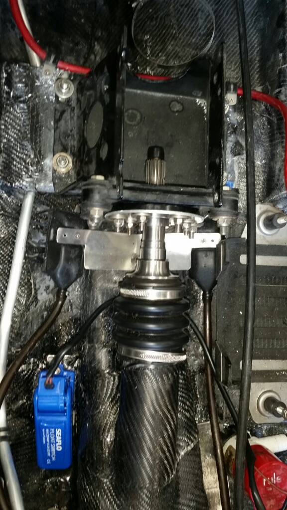

because a float switch will work if you leave the ski in water overnight. the original style wont unless you have the key on

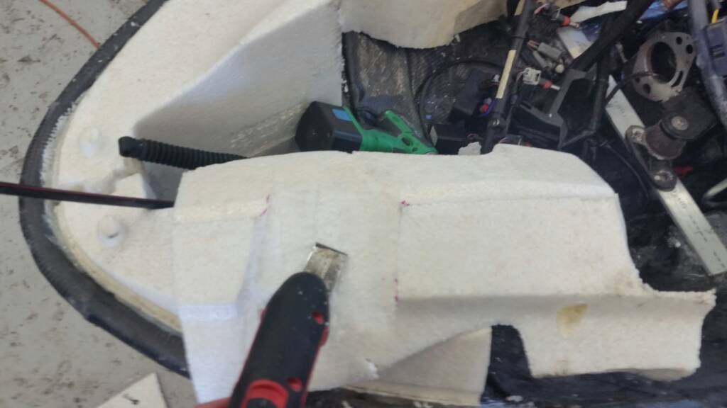

You got it CR! Im a bit stressed about sinking this thing having lost a CF Bullet HX in Pacific Ocean. Im missing all the internal layer foam. The float switch has to come up two inches deep of water to kick in. Been running these for decades and they are tough as hell. Cheap insurance! (:

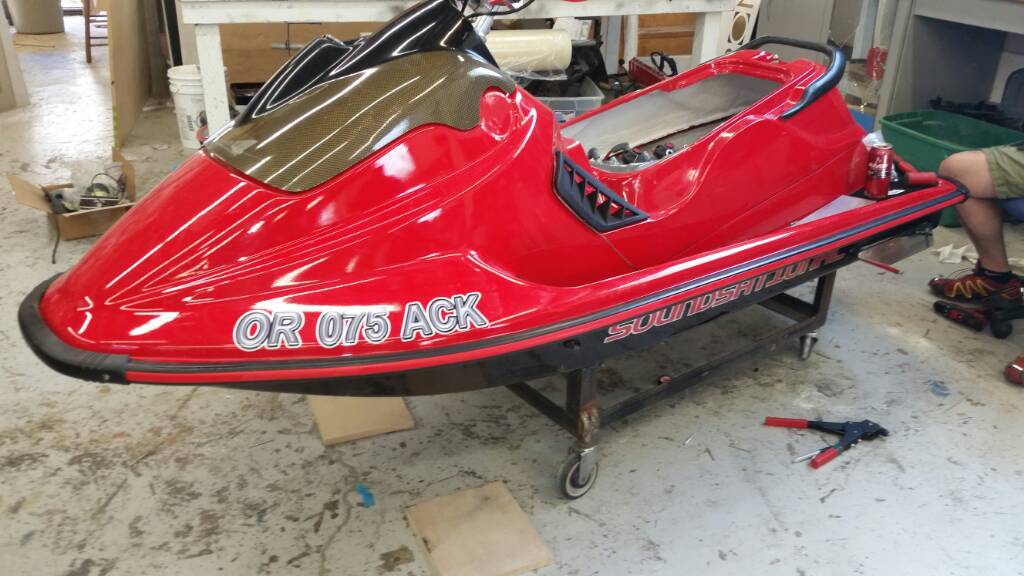

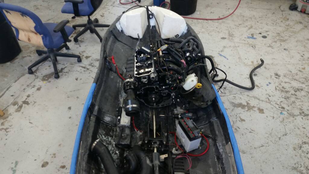

Lol.. thought about just swapping vin from donor xpl. They use a special rivet thats noticable. My first CF xpl i just ran dwn to local Sheriff for inspection. Had a trophy shop build a tag and all was legal. And yes I wanna ride too dang it. My excitement is causing to hurry through simple tasks..gotta slow . Only 120 days into building a Seadoo from scratch! (: Target is July. So my plan is just assemble this shiz show with ugly cosmetics and test-tune to validate concept even works. The september tear down top for radical paint scheme. Motor has arrived to Hartford Conn for rebuild by Chris McClennan. Had to put brakes on 350hp build and settle for 250 range. Should be fine in a 450lb boat.

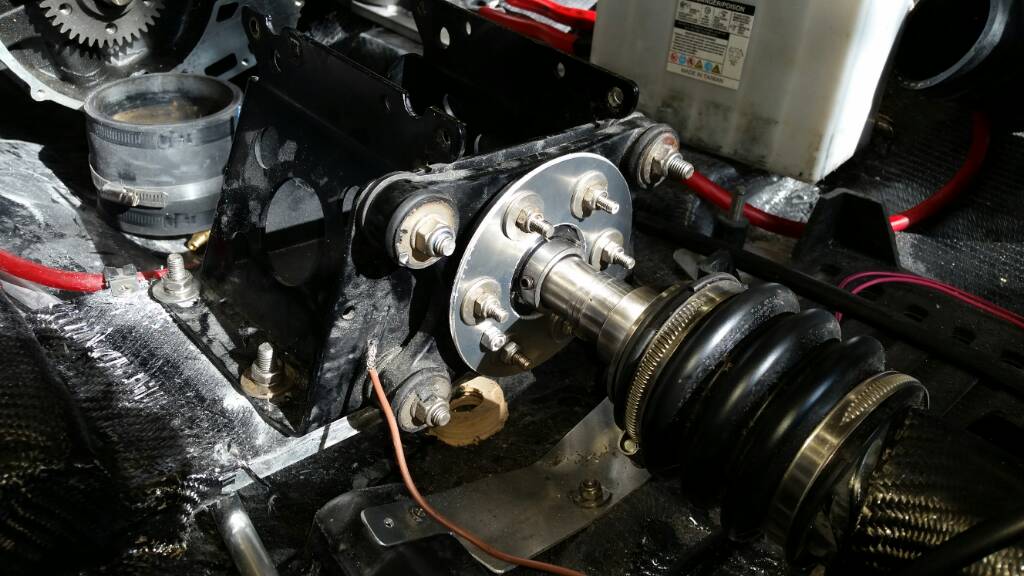

Made huge progress on most challenging part of this build. If this driveline set up works, I will be overjoyed! Dropped of parts to machine shop today, their response was " challenge accepted!" Spent 5 hrs building bearing carrier. Stepping to larger diameter shaft size presents a complicated puzzle for assembly, durabilty, serviceability and just flat safety. Spinning a two piece drive line at 8500 rpm between my legs, that I Budweiser engineered, has me concerned. Here is some photos.

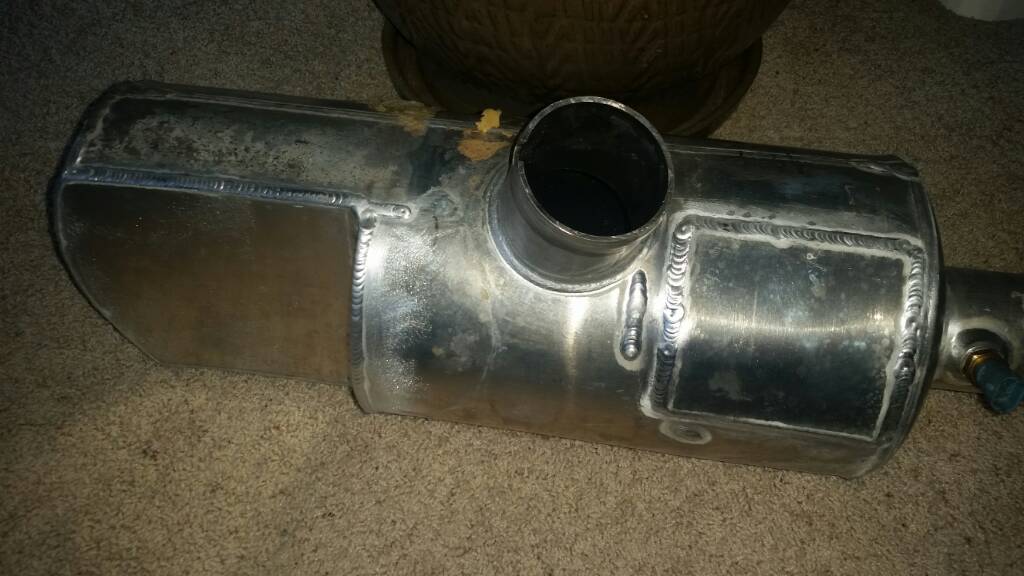

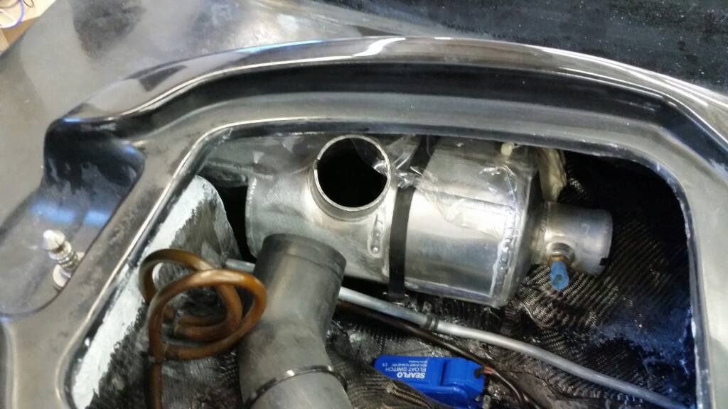

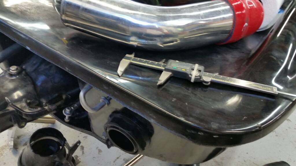

Big Kudos to my kids 17 yr old friend for doing some super pro welding on my water box. Notched side, partial gut internally, relocated inlet and reverse flowed WB . Anyone know what sensor is? Over heat sensor?
learning as I build. 4 tec exhaust is bottled dwn from 2.75 id to 2.25 id outlet on hull. Assume with mods, this non condusive to performance gain. Riva 3 inch outlet onda way!

Nice. That's something I don't have in my carbon fiber hulls. I've thought about the fact that they would sink like a stone.
