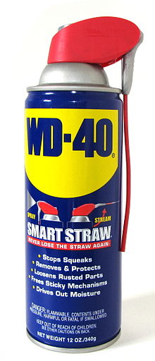

See if you can locate this stuff Kroil penetrating oil or WD-40, or PB blaster. Just keep soaking it. It's not so much the piston expanding, but when the aluminum oxidizes that expands and will "rust" the cylinder. Think of it like a doorstop that looks like a wedge. The oil needs to get worked down around the cylinder and the piston. And yes, I have had a piston oxidize to a cylinder wall. I have spent the good part of a week trying to free a snowmobile engine before, just to tear it down. I just wouldn't beat on the crown(top) of the pistons, especially if you think you MIGHT want to re-use them. That will depend on what the rest of the bores look like, I'm gonna say you need new ones and probably a bore job. And then when you get it all free you'll need to put the head back on and put a rope in the cylinder to get the PTO off with your new puller.
