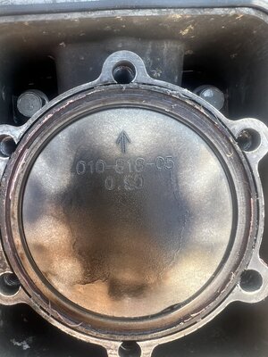

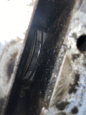

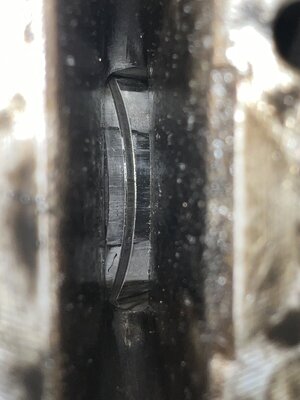

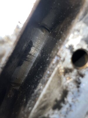

I have a 1997 seadoo spx with a group k sleeper kit I recently installed. I got a little paranoid about making sure everything was good so I popped the rear cylinder rave valve off and it looks like part of the piston is scored. It only runs about 1.5 cm down the piston from the top, I can’t tell if it’s something I need to worry about or not. I poked the lower ring and it isn’t Locked in the piston, it moves in and out. The thing runs great, I topped out at 60.2 this morning. I’ve got 150 psi in mag cylinder and 145-147 in the pto. I was running premix at 40:1 but after seeing the scoring I premixed it to 32:1. About two and a half hours on the engine, new crank, new pistons, both wsm. I’m just putting down the information for reference. Thank you all. I’m also running XD100 oil full synthetic
