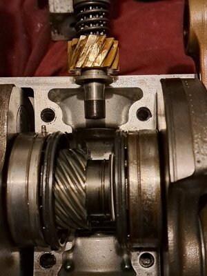

Hi Mikidymac, see attached picture you can see the brass sprocket teeth is worn , this was part of the damage from the rotary valvePer page 04-07-02 of the service manual 0.30mm +/- 0.05mm
Was thinking a blow tourch to heat it up then try knock it down with a screw driver , concerned about the seal next to it getting damagedIt definitely has moved.
I am not sure the best way to get it centered again but our resident machinist @etemplet might have some ideas.

HiI haven't tried to reposition a crank gear yet but chances are if it moved once it will move again. If I only wanted to move it over without damaging it I'd try a hose clamp tightened around the Diameter and gently pry on the clamp or try using 2 clamps separated as much as possible. Any force applied directly to the gear will likely damage it and no heat can be applied. Need to solve the problem with the gear losing it's location. What caused the brass gear to wear? Was it that the gear on the shaft moved? Whatever you do... very gently. I have a crank open in the shop I'll take a look at it tomorrow. Something has to locate the gear and lock it into position. 6500RPM.... it's just gonna move away from thrust if it isn't secure.

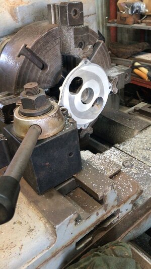

The assembled measurement, since I don't do millimeters, is (.010" - .014") I use a piece of (.032") solder to check the clearance. I have taken measurements of (.017") and had no issues with engine starting and I think you can get away with more than that. Most of these covers are worn even though the readings are not all that bad. Here is a picture of a cover I did while back in the lathe. The job is kinda tedious but that's what we do. You learn a lot about how these things wear when you are machining them. This cover was worn pretty bad.

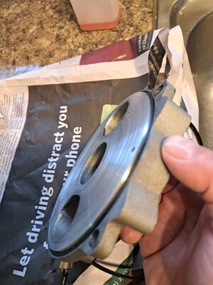

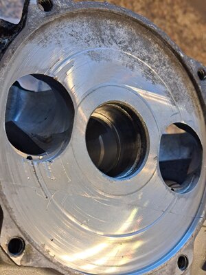

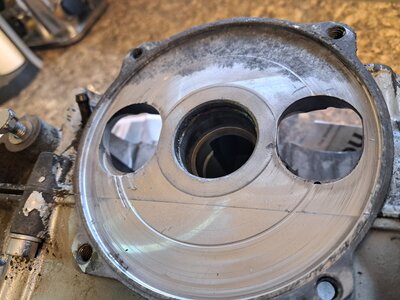

See attached pictures I don't think much work needs doing on the cover it's the block part that has the bad scratches
