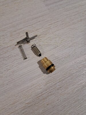

I started on the side with the need valve , see attached picture of it, I replaced the oring , not to sure if there is supposed to be one on the bottom?
According to my manual I don't belive one is fitted there , am I correct?

Not quite understanding your last post, you tried testing your pop off pressure? Was that before you changed the needle and seat or after you put the new one in? Did you replace the spring beneath the lever? Where did you purchase the carb rebuild kit from? What is the pop off supposed to be for your model?

I only apply 4 pounds to the pulse nipple, People may recommend 10 pounds but the manual must say 4. I’m always worried about damaging something, lol. Can’t quite remember but I think you need to have the inlet and return nipple looped together with a 1/4 inch fuel hose when pressuring through the pulse nipple, I will double check and post back if different. So when you were testing your pop off, where there any bubbles coming? Not sure about the pressure the needle should seat at, you would have to check your manual to be sure, I think the carb on my HX reseated at 40 pounds. If you do have all appropriate nipples blocked before pressuring pulse nipple with 4 pounds it would indicate a leaking needle or bad diaphragm. Too bad your rebuild kit didn’t come with new needle, seat and lever, especially since all indications pointed to leaking needle or bad diaphragm holding it open in first place.

Just read through your message again, I double checked my HX thread and it is supposed to hold 4psi in the pulse nipple and not 10 so maybe the pump diaphragm isn’t sealed or is damaged. The 10 pounds you may have read about is into the inlet nipple after it is all put back together, pretty sure this is to check that, the needle is seated properly and holding after it’s all back together. As for the reseating are 20 pounds, seems a little low to me but best for someone else to chime in. I know in my 717 HX it seated at 40 pounds and manual said minimum of 24 pounds. Did you use Mikidymac’s carb rebuild thread? It is really good and easy to follow, I think you should order a genuine Mikuni kit from OSDparts.com with the new needle, seat and lever and know everything is good.

You really should replace the needle and seat with a rebuild.
