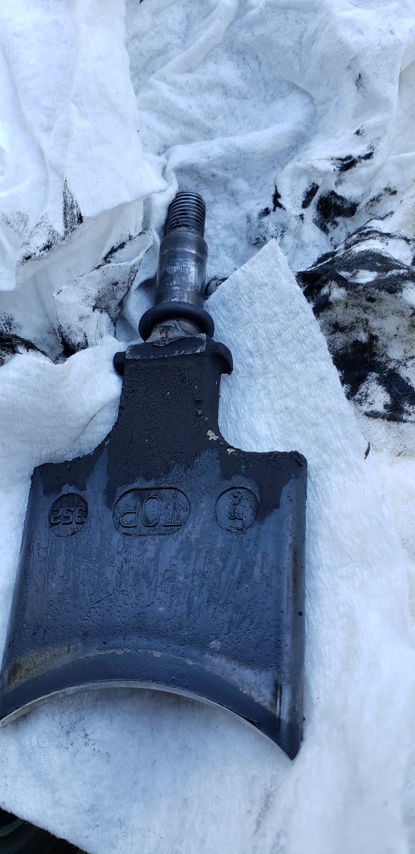

With that being said at the end of the season I started noticing some issues with my ski, and found this last fall when I went to winterize it. Ears busted off the rave valve and melted the cap. Cylinder looks fine and no adverse side effects, so I'm guessing this happened the last ride of the season or close to it. I've ordered some new(used) raves, housings, etc in good condition. Didn't feel like shelling out the cost of those things new. Parts should be here this week I'd guess. Maybe I'll get some time to pull my carbs and go through them again. Getting a hot start issue again that wasn't there when I first put the new carbs on.

Well mine was cause the ears on the rave broke, so fortunately I found the reason. When it was running I saw exhaust come out the top, that's why I started poking around.

Got the new raves today and put them in. Now just need to put my head back on, it's "on" in the pic but the bolts aren't tightened down. Gonna pull them off and go over them with a bench grinder to get them cleaner.
