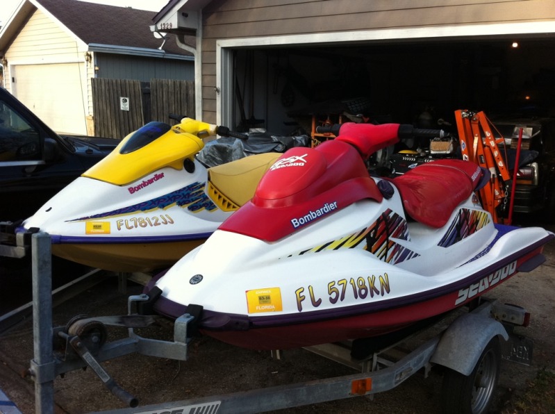

Don't have a pic of the GTI but here are the GTX's

For the price... if they are already on a double trailer... then it's a gamble I would take (if it's 2 single trailers, I'd pass)... assuming:
1) They will start without any starter fluid. (just a choke)
2) The compression is good.
3) The electronics check out.
At that point... a pump rebuild, or minor cleanup is easy.
Before bothering with a compression check... see if they start. Older Rotax 2-stokes have a nasty habit of leaking oil though the center seals. When that happens... the engine will basically be hydro-locked with an oil/fuel mix.
If they start/run... shut them off after 10~15 seconds... and then check the compression. Even if they don't have a real center seal issue... there can be extra oil in the engine... and starting it for a few seconds will purge that out.
Finally... DO NOT use a charger, or jump start the skis !!!! the MPEM (computer) is VERY sensitive, and they are know to burn out if you try it. So... go buy a new battery, and make sure it's charged. Then... put it in the ski. (don't use cables) Sometimes you get too much loss down the cables, and they won't crank. (don't use a jump box either)
