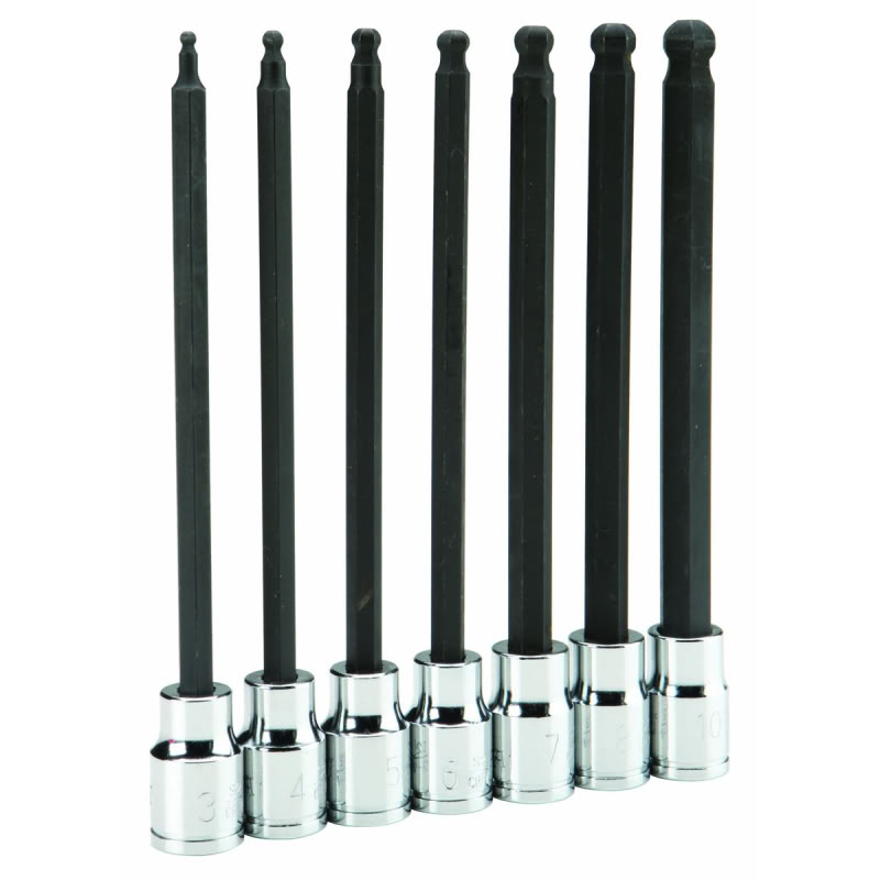

Long ball head hex sockets are great for the bolts on the tuned pipe on the 787.

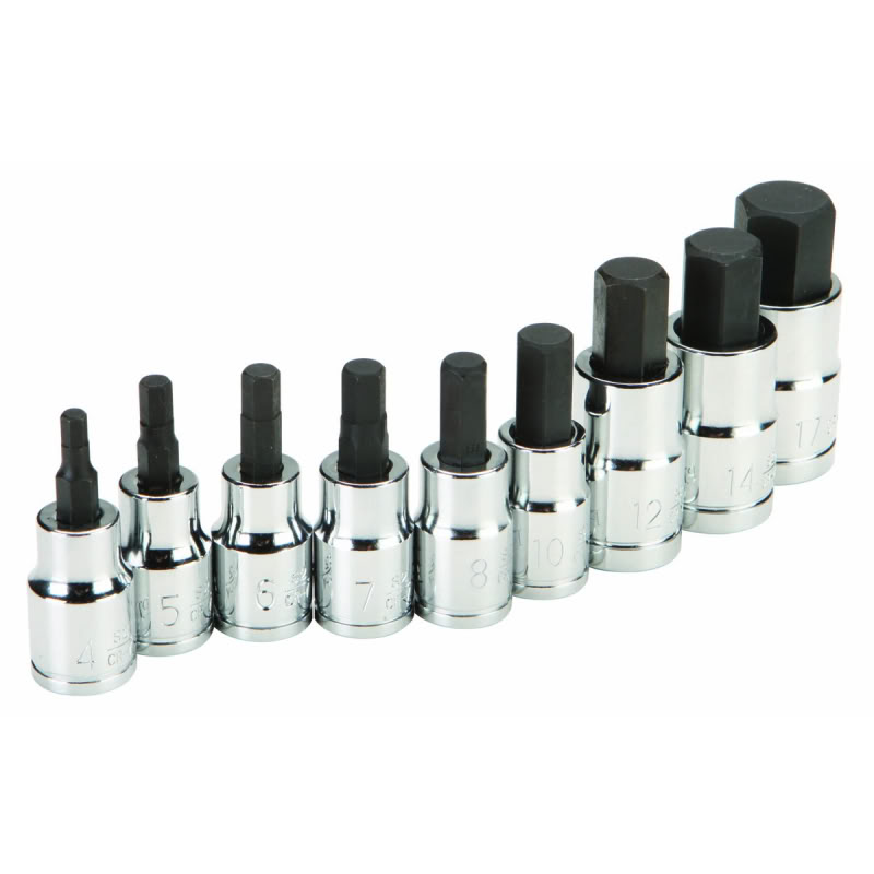

An absolute must is regular hex head sockets
