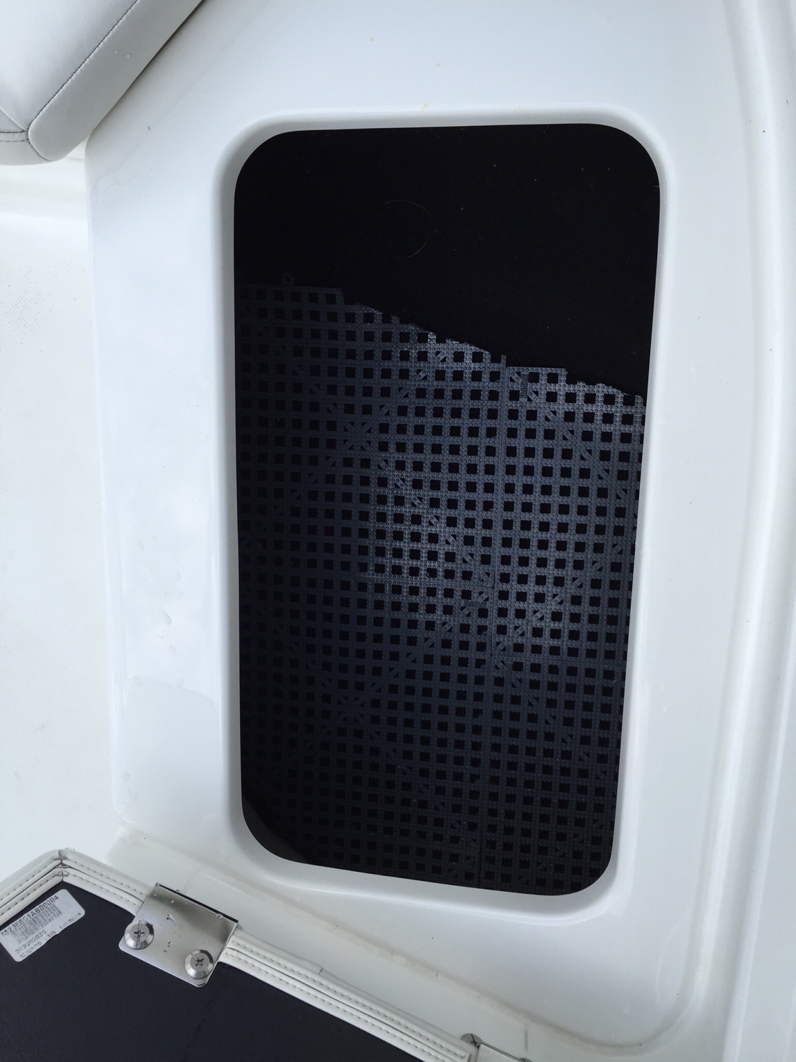

I bought a rubber grated mate at Lowe's that I cut to size to fit each compartment on my SeaDoo. It is a little over 1/2 thick and keeps the stuff I store off the floor dry. As far as the anchor and rode I store in a Rubbermaid container that I drilled out to drain. That also sits on the rubber mate. Doesn't keep everything dry but is a whole lot better then before.
I've used dri-dek in a few of my storage compartments. I like it, but it's not reasonably priced, in my opinion. Sounds like I need to go to Lowes and do some looking.
We buy DryDeck for work by the miles and I can tell you for heavy traffic areas it's amazing and lasts for 20+ years but there are many knock offs at 1/2 the price...and the stuff you get at the big box stores is great.
An option worth considering for those more adventurous. I've purchases tongue & groove teak on eBay (very cheap) on many an occasion and when we had left overs we strip off the tongue/groove on a table saw and use the wood for crossed/gapped projects such as shower floors on larger boats. We've also made some hatch compartment raised floors as your need is...this give is more height then a dry deck and looks pretty cool too!
Fake dry deck is easier!
