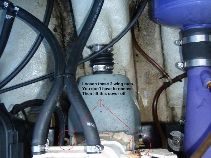

From the outside... it's hard to tell if your carbon ring is warn. (unless it's broken) The problem is... it can be warn uneven... or the boot holding pressure on it can be getting soft.
BUT... you can try one thing. Pull the carbon ring away from the stanless ring... and put a small blob of grease on the face of the ring. The grease will help seal it up. If the cavitation goes away (or is greatly reduced) then it's time for a carbon seal rebuild.
One thing... on some boats, the driveshaft has 2 or 3 clip locations. if your's has this... you can move the stainless ring up, and put more tension on the seal.
I'll post a few pics to help you check your seal for the extra clip slots.
Just curious because of the corrugated rubber boot on the carbon seals. Mine is a straight piece of rubber tubing and that is what the parts diagram shows as well. Did your boat have the corrugated boot originally or is mine wrong? Getting ready to rebuild the pump and driveline seals and could replace it if necessary.
95? I doubt you have a carbon ring setup like pictured above, you have a straight hose with a carrier bearing setup, much better.. :)
Correct me if im wrong, but doesn't seem like to be a sealed cover rather than a protector kind of cover from stuff hitting or laying against the moving shaft
I think it is also there to prevent the grease from splatting all over should the shaft boot ever split open.
