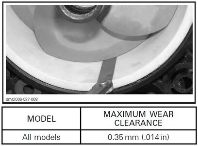

2022 GTR230 impeller clearance
Mikhail2400
Installed new wear ring and had cavitation. Noticed the impeller had a broken tip on one blade so we in stalled a new Solas impeller. Still has cavitation out the hole. Im hoping someone can answer a couple questions.
1: Whats the standard clearance between impeller and wear ring
2: Is it possible for air to leak from the hull to the water pump thru the carbon ring but not water in the opposite direction
Thanks to any of you who take the time to look this over
