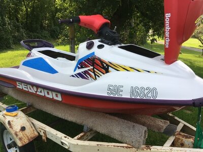

ABD88080-FA54-46A1-A0C6-D482DCC4DC25.jpegI’m getting this 97 GSX taped off so I can give it a quick once over with power cut 91,49 then the 45. I have a lady coming who I think may well buy it. Definitely having mixed feelings about selling it, lol. Never sold one before, I get to attached to them but I’m finding 7 running seadoo’s is to many to maintain. I guess I can’t lose though, I either get what I want for it or I still get to have it😀
