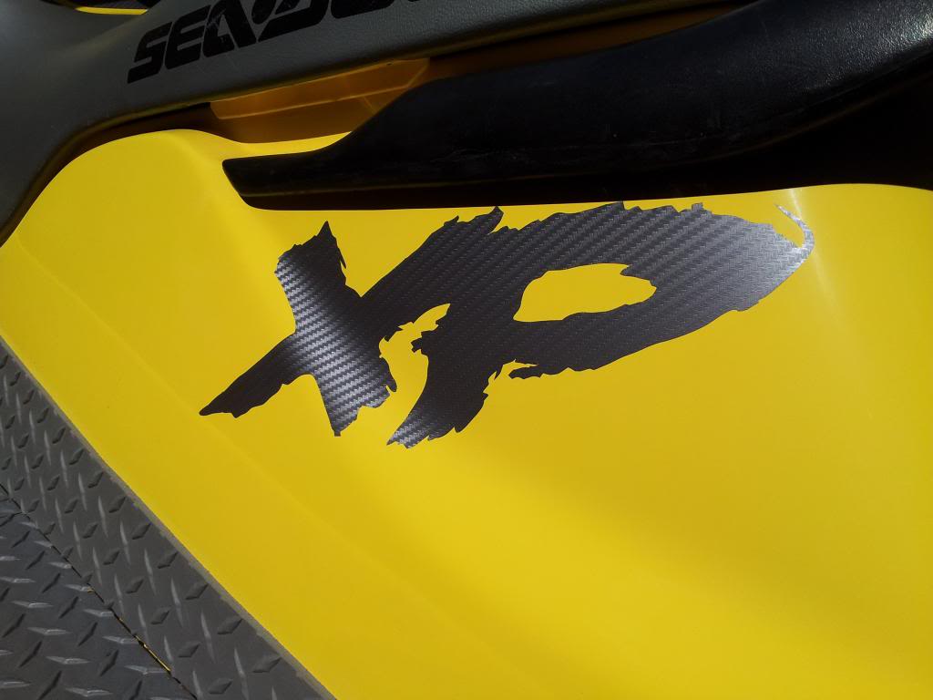

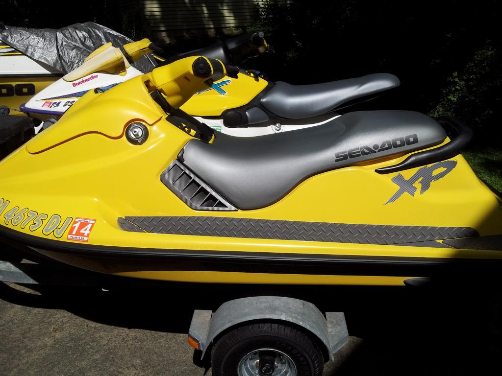

Ive had machines with both HT like Dan's ski, and the foam blocks HT sells. I personally like the blocks but they need to be glued on to actually hold, and once you do that good luck getting the glue back off if you need to.
They are alot like stirrups on a horse...something to hold you to the ski.
Unfortunately my brother hates the blocks, and rips them off if he rides my ski. Princess.

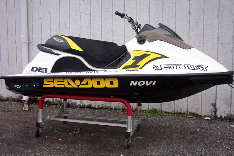

I saw it on an X4 that was for sale in Hawaii, claimed to be a pro racer ski, but I don't have any pics of it.
Something like this would be ideal:
Now that I look at it that might be a Jet Trim product.....

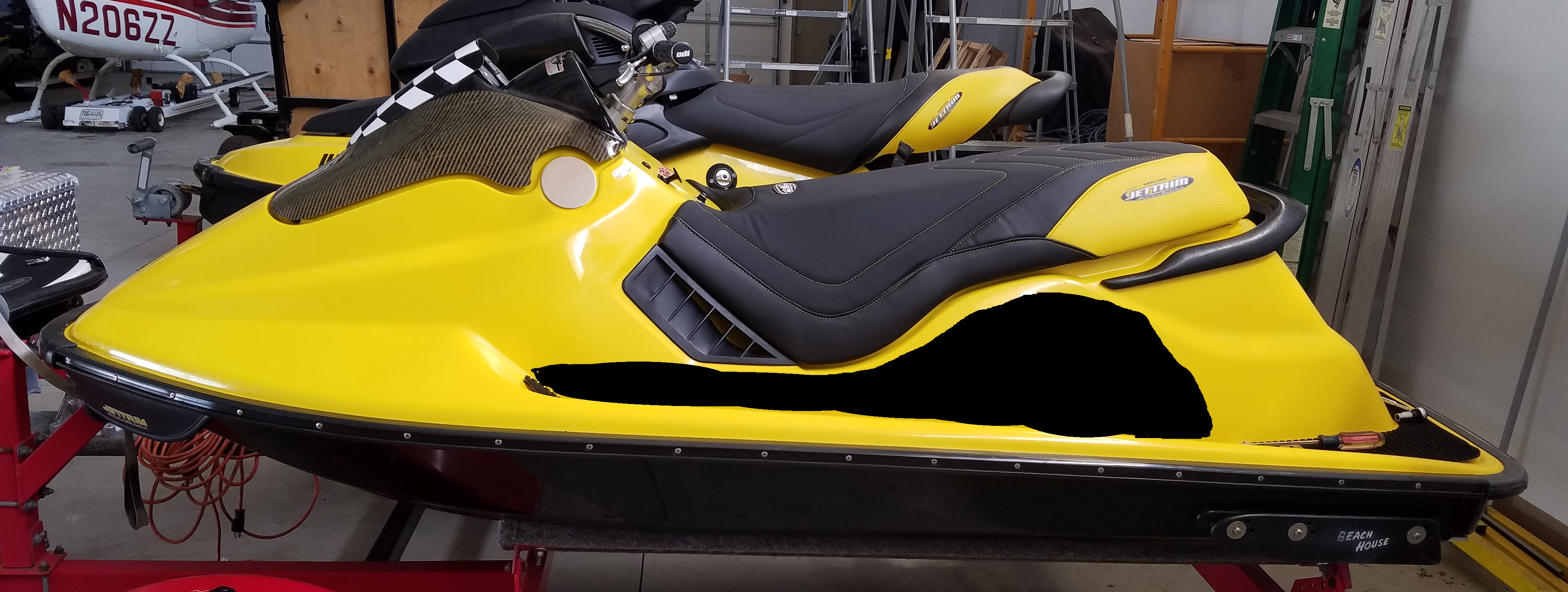

hrm, well I got an email from Jettrim saying they couldn't find the template for the tunnel mats I want so I can either provide them one or return to my original plan of using turf. Here's what I'm after:
the only issue is I am definitely not an artist. I am going to take this to the interior shop that redid my Supra. They do custom seadeck work.
Go to Michael's or AC Moore and buy some tracing vellum. Then trace the actual profile of the ski, easier to see thru than cardboard. Then find a block of what ever width you want to offset from the line you traced and follow it all the way around. Or you could drill a hole in a small block of wood and insert a pencil in it and use the edge of the block to follow it around. Small block to follow the profile better. Then transfer to cardboard. Probably take you about 30 minutes. This way you're duplicating the exact profile.
