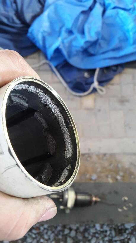

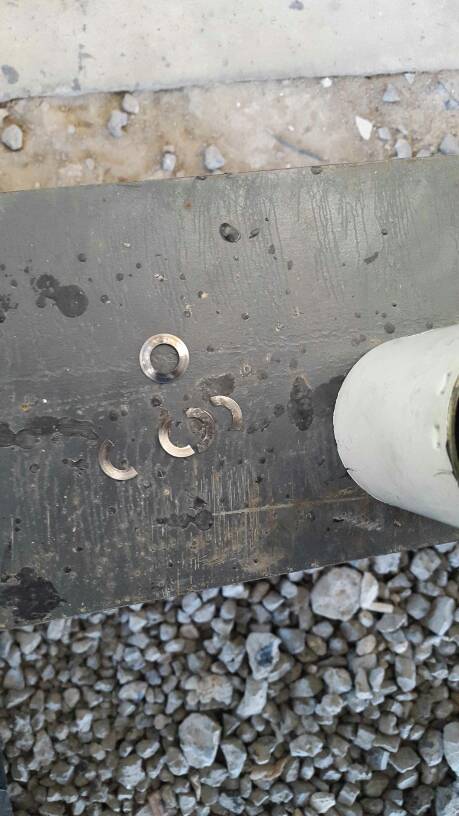

Thanks doc! I broke my starter... again... and also the race was suspended due to an accident here in the river, but I will have news soon!
Thanks to everyone for the support

Did you snap the no shaft off of it?
Enviado desde mi SM-G900H mediante Tapatalk
I have been buying these 787 eBay $45 starters, shipped, and they have done very well
I just put a new bendix and brushes in mine. Been working well for me, but I bet those 45$ starters have the same brushes and bendix that I buy...
IDO I tried rebuilding many starters. Fail but what do I know I do I know, I own a 12 volt stereo shop. The trick and lose old starter motors is original SD was a 9 tooth starter and the next generation was an 8 tooth star which made significant increase in cranking speed. These boats will not start via ignition system voltage gets too low. Hence why they always start out of the water with no resistance
I've snapped shafts on the first crank with those cheapo Chinese starters. They are just about guaranteed to strand you on the lake early in their lives.

Yep, they're a pos. I buy genuine nippondenso replacement parts for my starters.
