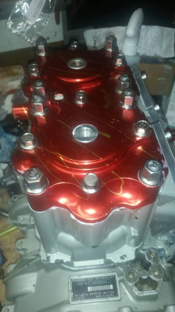

Still have not finished yet with the motor. I had a leak on the head at the water jacket. Pulled apart decided to get an aftermarket head.
I got a decent deal. I'm going to keep it as a back up for if I need to tear the top down you probably have new pistons too huh matt?
Pressure testing complete 5 psi on crankcase side and cooling side for 8 hours. 0 drop. Have to check the squish again forgot to before I sealed the head. Used a 6 hole base so I'm hoping it will be good. If not I'll be tearing it apart yet again [emoji35]

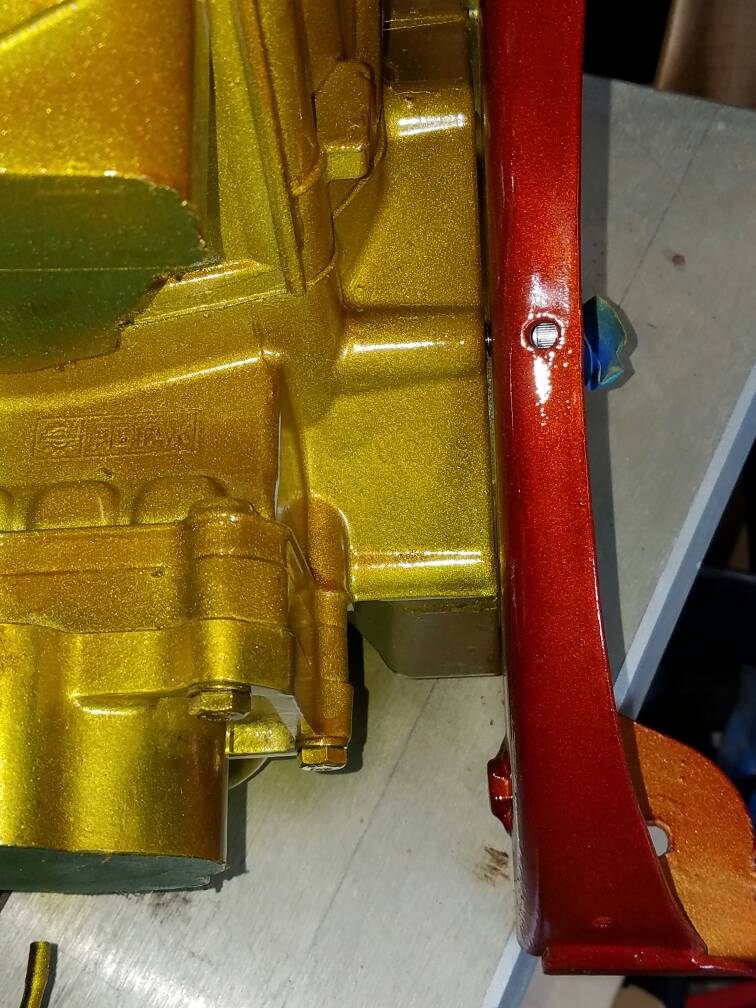

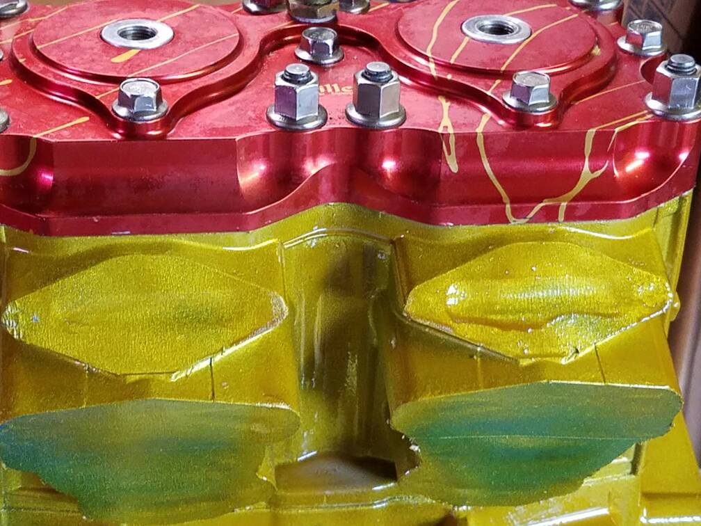

This is what it was supposed to look like looks more gold I'm not 100% happy but it will do, no time to repaint
