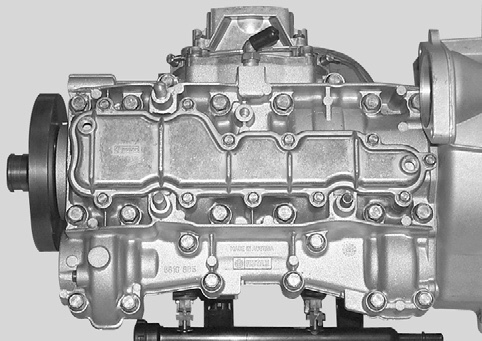

Dave, With that amount of water I would guess it is coming from the case cooler. The cooler pan is most probably plastic like the DI's and it has cracked.
Just to make sure I understand, you guys are talking about part number 290811236, WATERCHANNEL COVER, which shows in the crankcase sub assembly parts list.
Right?
Also, looking at the Shop Manual, I cannot find any reference to this item. I think this is a picture of it while they discuss the assembly of the case halves:
But I cannot find any discussion on it at all in any section. That means I do not see how to bypass. This looks like a cover on the bottom of the engine block water jackets. I do not see any input, although the output is that drain line I replaced, I think.

On the mag end the fitting screws into the cover and the hose runs to the mag cooler. On the pto end the fitting screws into it and runs out the back.
If you find the leak there then the engine will have to come out in order to repair/replace.
I know where the cooling hose goes into the mag cooler, it has a quick disconnect on it. I also see where it comes out. Looking at the picture, it looks like there is a threaded fitting hole on the mag side. If the output of the mag cooler goes to that fitting, I see how you can bypass. Simply route that to the drain line that connects to the fitting in the PTO side. Where I replaced the hose. Right?
Yes. I would do that for testing purposes, but not run it that way for and extended period of time. I know you won't, but it would be a good way to find out if that is in fact the problem.
I see it in the water circuit in the Manual. They show the 2 fittings but conveniently do not show the water channel cover.
