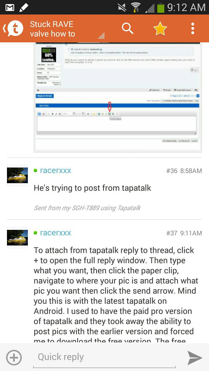

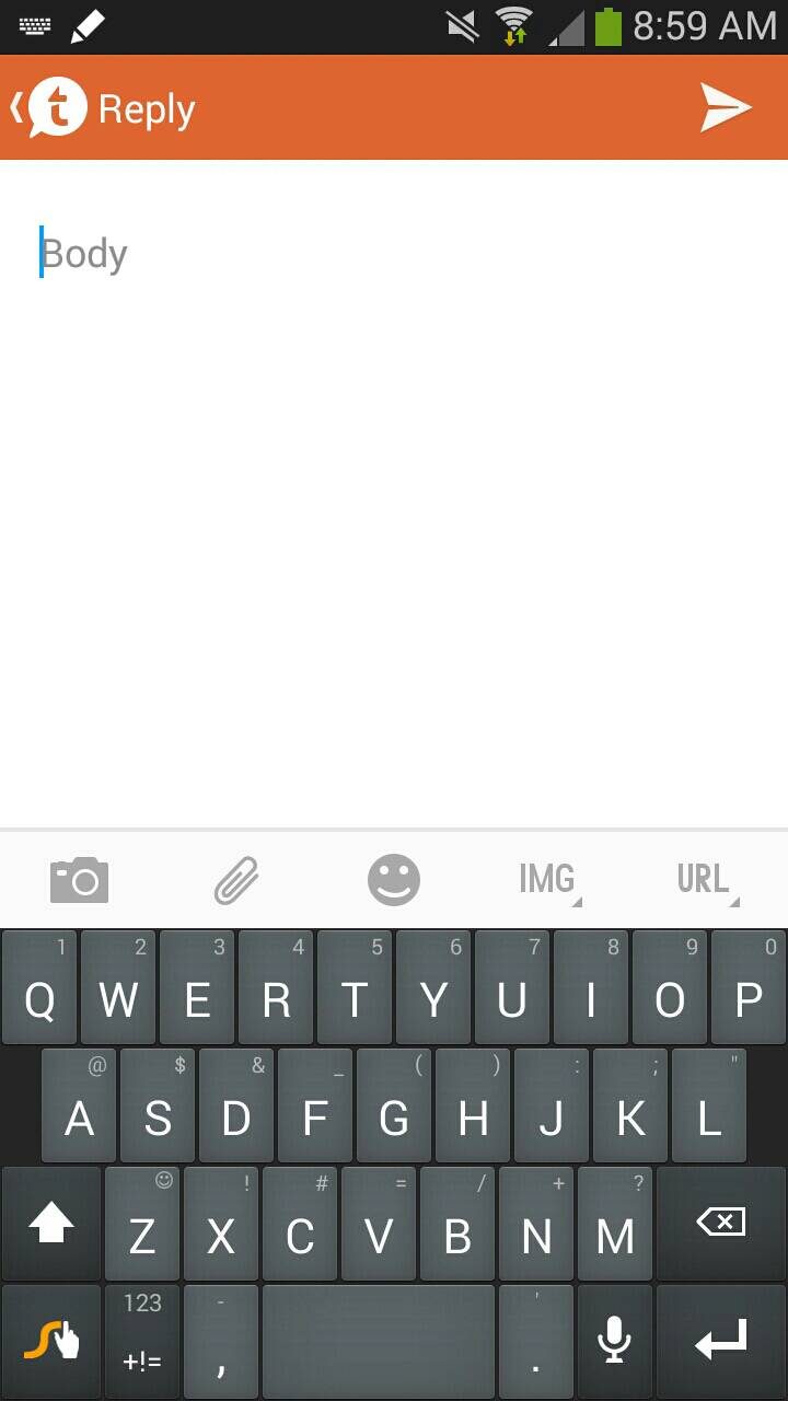

Lots of updates on those critters . Wish I cud publish photos. This site will not upload photos.
What do you mean? to upload a picture you have to click on the little picture icon and a little window opens asking were you want to load from,computer or a url.
To attach from tapatalk reply to thread, click + to open the full reply window. Then type what you want, then click the paper clip, navigate to where your pic is and attach what pic you want then click the send arrow. Mind you this is with the latest tapatalk on Android. I used to have the paid pro version of tapatalk and they took away the ability to post pics with the paid pro version and forced me to download the free version. The free version has a shitty layout in my opinion, to much back and forth and useless clicks to get something simple done. So I use the pro version to read the forum, then if I want to post a pic I use the new free version of tapatalk.

[MENTION=57920]racerxxx[/MENTION]
You beat me to that i was saving the screen shots when you posted lol
Lol, I've been meaning to do it since the last time he posted that he could do it on GH but not here. I had a few spare minutes and knocked it out. Lol. Is yours on Android or iPhone? And if it's on iPhone is the interface the same?

Does your interface look like the pics I posted ? If so, clicking the camera icon takes forever sometimes. If you use the paperclip it's fast.
