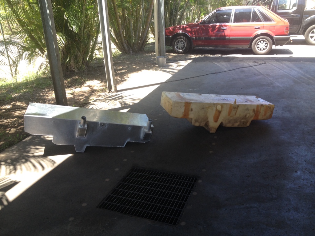

I shuld have done this from the beginning. Tank had really old stale fuel and plenty of gunk inside that tank.
What happened with your tankm
Mine was cracked!!
I had to make another one from alloy.
