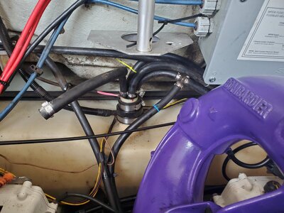

I have a 97 project that is nearing completion and found I have an extra fuel line coming from the tank that goes to nowhere. It has a clamp on the other end so I'm guessing it must have been attached to something at one point. I also have both fuel returns going from the carbs going into a T fitting to the tank (this is the line with the blue zip tie). The shop manual shows each fuel return has it's own seperate line. My guess is a previous owner combined the fuel returns into a sinngle line with the T fitting leading to the tank and left this extra retune line disconnected. I'm just not sure why this line is so short with a clamp at the end. I traced all the fuel lines and eveything else is going where it should. Any ideas what this is?fuel.jpg
4 fittings on the pickup.
1 fitting for the main gas pickup. 1 fitting for reserve gas pickup. 2 fittings for return lines from each engine.
The pickup itself has markings for each fitting (main, res, vent, ret). Obviously, some are repurposed, but they are all used.

I pressurized the fuel tank and noticed fuel spitting out of this line so I just pluged it and ran the boat for the first time like this and had no issues. I'll re-run the lines as shown in the shop manual when I have the time.
