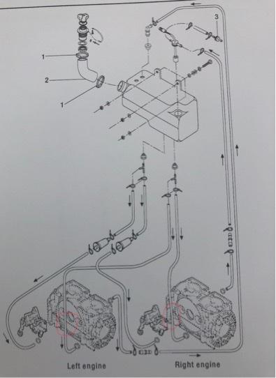

Hi, i am looking at connecting the new filters up tomorrow and still are not clear on the pipes direction in and out on the filter showing in the photo. would you be able to tell me what side of the filter pipes are coming in.
That hose should be soft and they don’t go bad.
That’s the hose you put the shutoff valve on but you have to remember to always turn it on. Some people put the lanyard on it so they don’t forget.
This is all I can find I can't actually see a photo from our discussion on this the shut off valve I put on the oil line is from the oil container to the bottom of the engine is not the pipes running to the Oil pumps ?
No not the ones to the pump.
