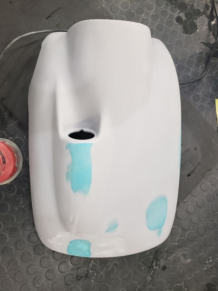

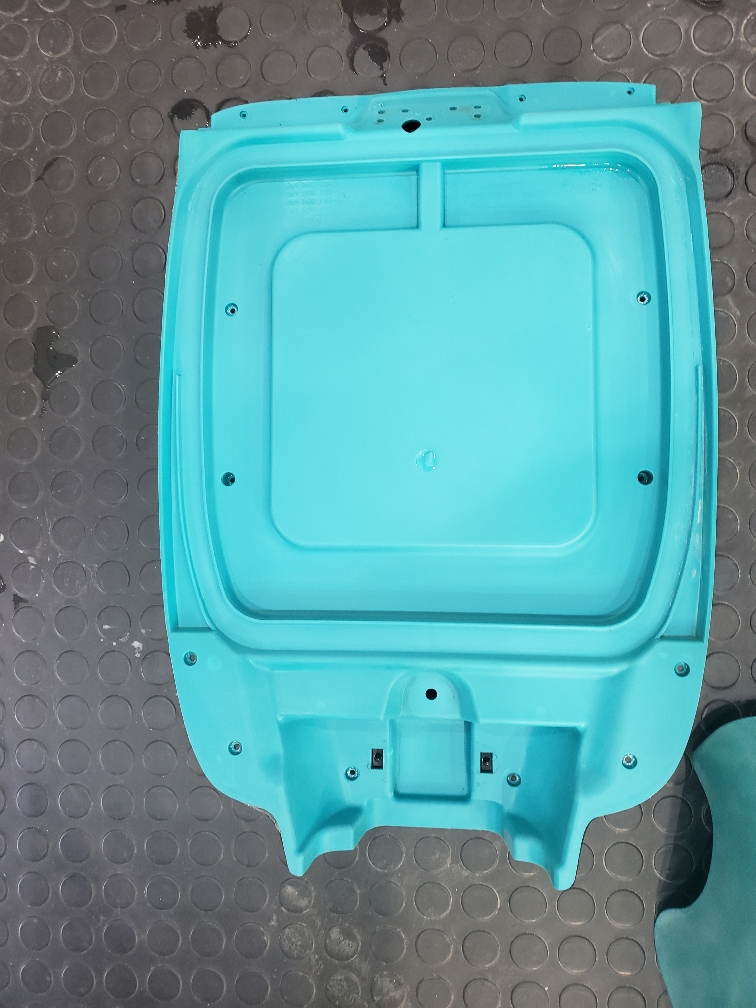

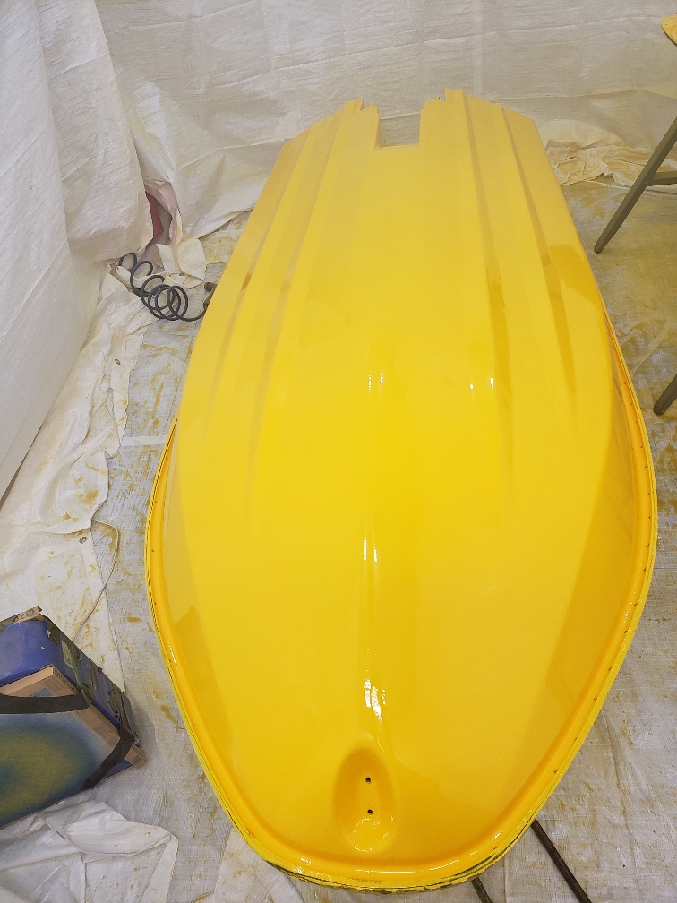

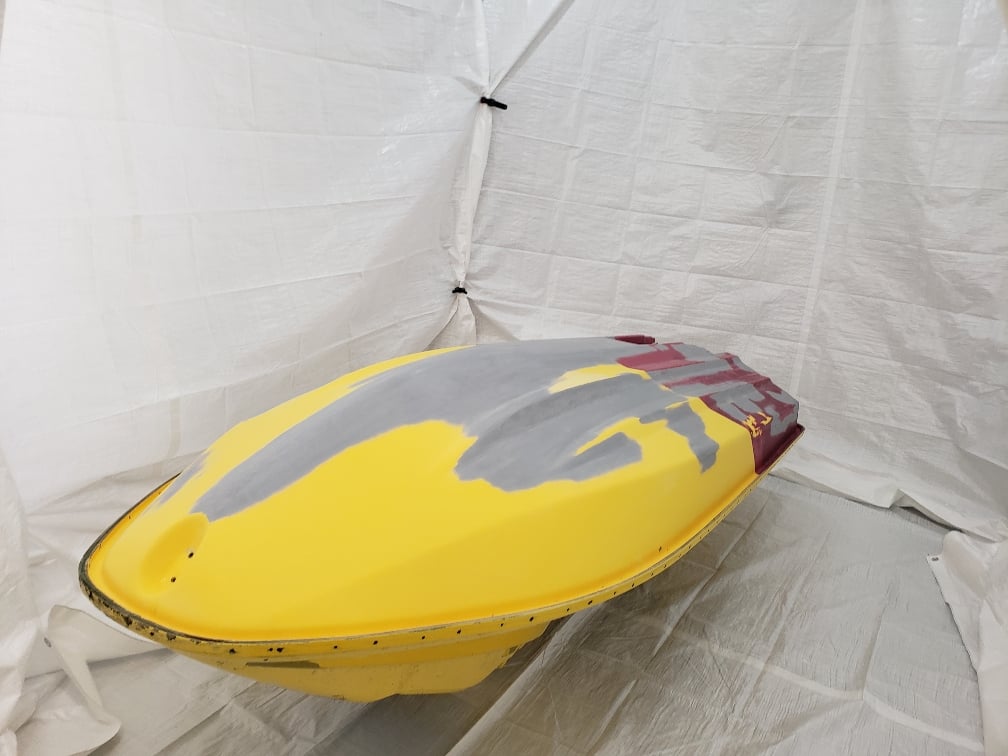

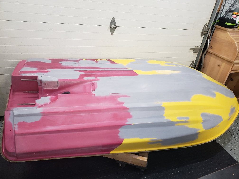

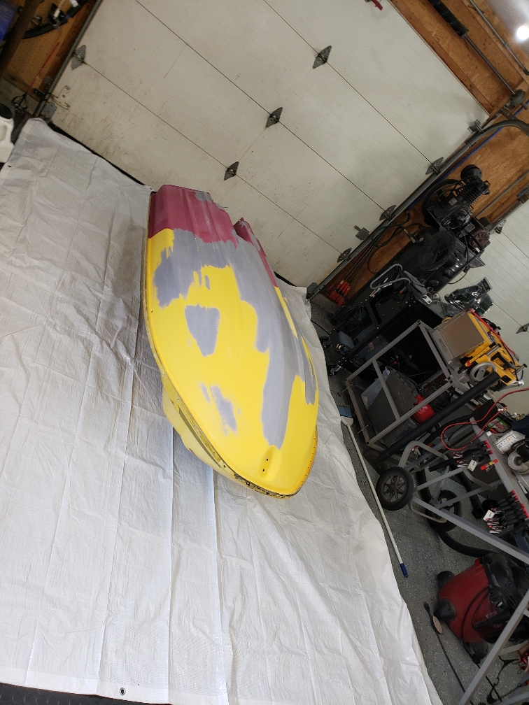

Thanks matt. Im getting some stuff done. I got the hood sanded and then primed. Found some more scratches that needed sanded so I hit them. I have it in primer again now. Just need to sand a few spots on the bottom of the ski and it's ready for paint. I'm also taking the rx apart right now.Yes gauges work. You have to use the RX throttle cable if you use the RX MPEM because of the TPS.

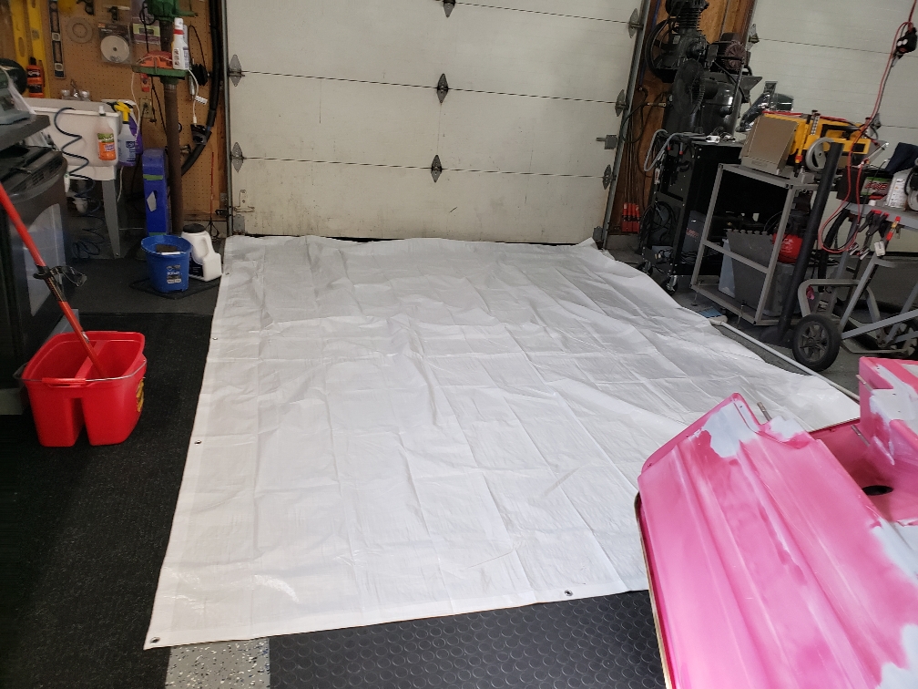

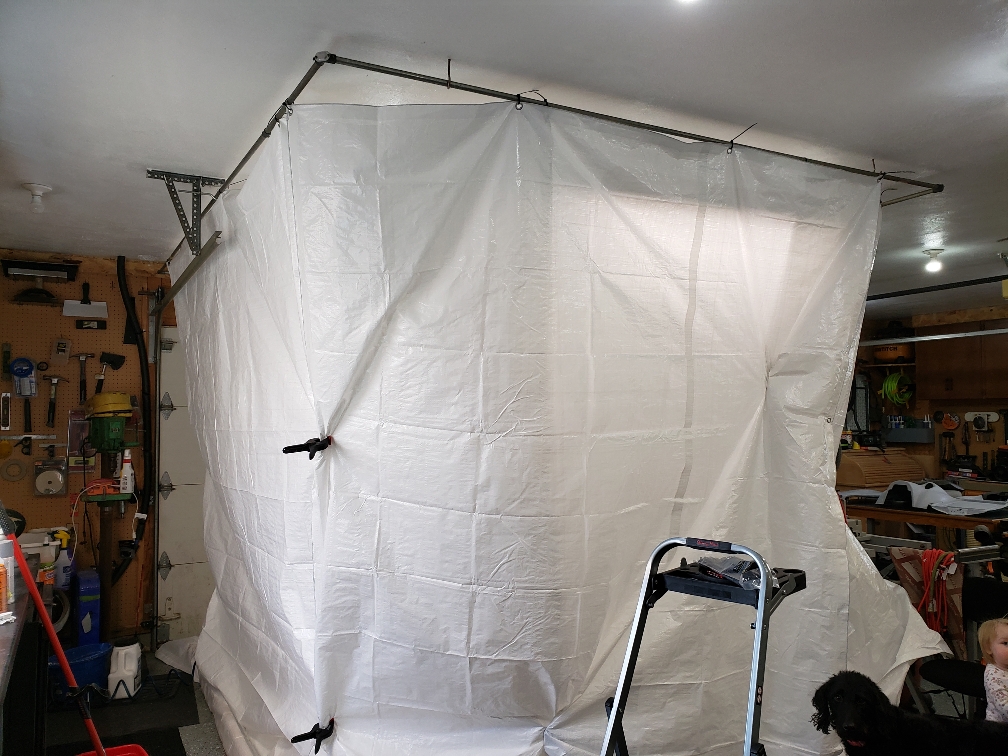

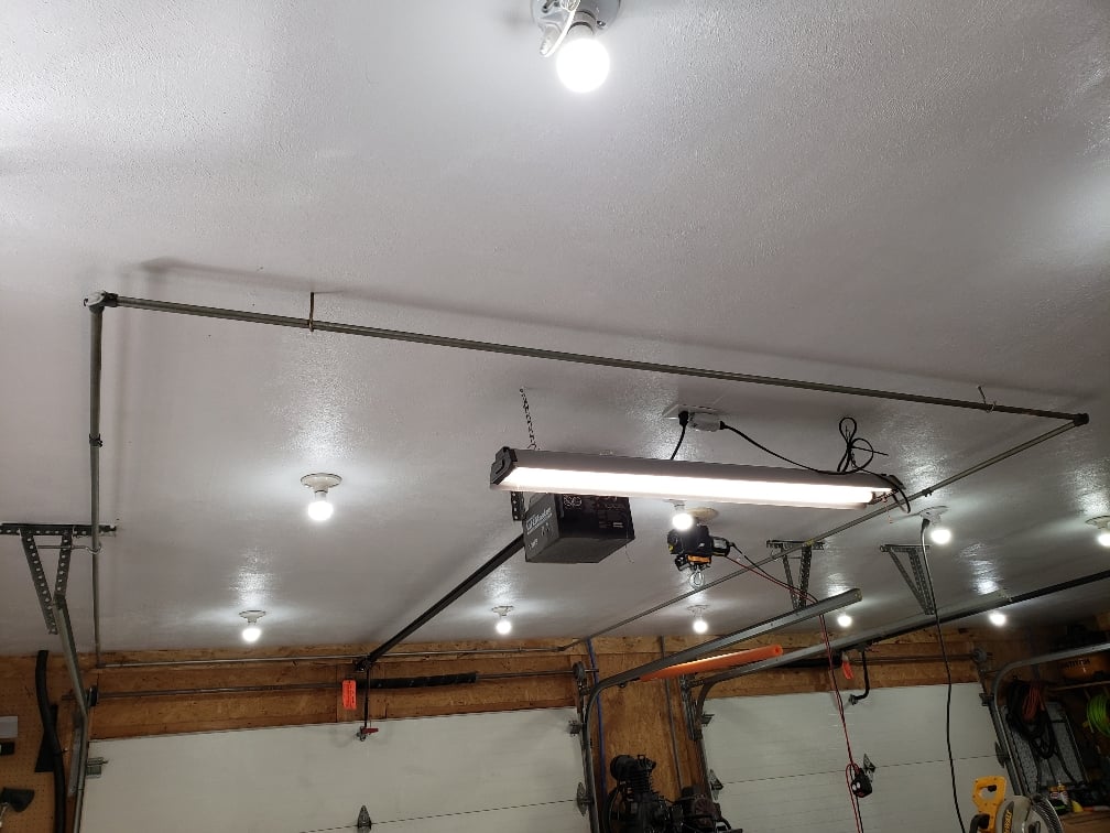

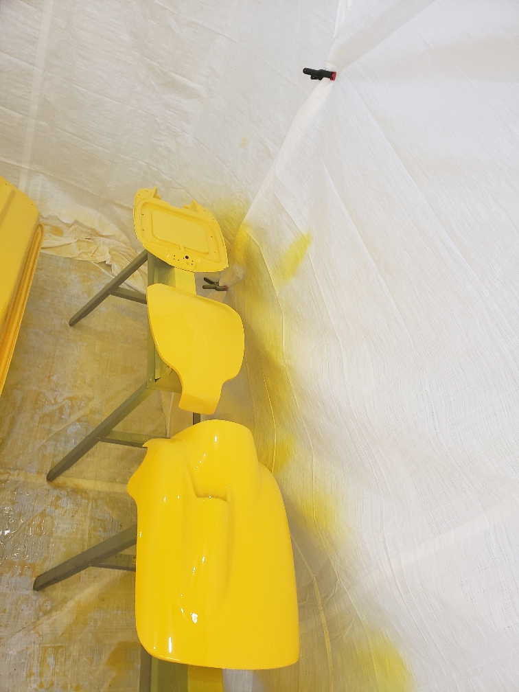

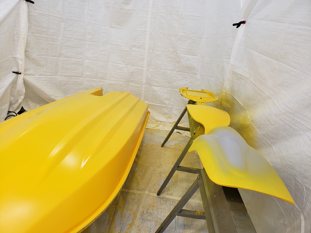

the room is 12ft long by 10ft wide. what i do is then take 4, 2by4's and make a box. this way i can wet the floor and walls with water. I then take a 20in box fan and put a filter on both sides. i set this right inside the paint room and put it on 3 (high) and let it go. As far as ventilation goes i have a bathroom exhast fan built in to my garage ceiling that i used when ever im doing something that smells and it dumps the stuff right out side. I also heat/air condistion my garage year around.I would be interested in knowing what you used to enclose your spray area and how you set your fan up for ventilation. I would like to do something similar but a little larger. The white color is great for reflecting light so you can see your work better. Thanks.
so, i should have the rest of the yellow paint tomrrow. i'll get that finished up but in the mean time i did get some more parts. i got a 155mm pump wedge along with a red top drop trim.

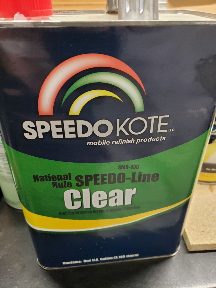

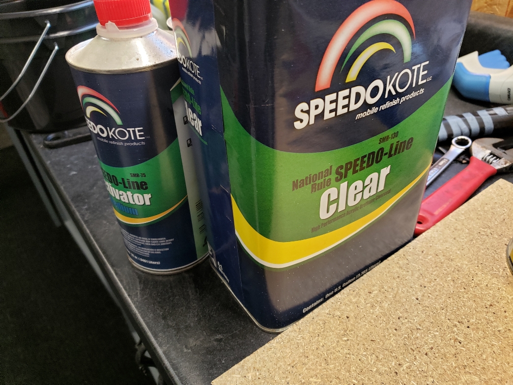

Yep you can make the room for $20 at menardsI'm surprised the solvents in the 2K don't attack the lacquer.
Are the walls just lightweight white plastic tarps? Thanks for the other info.

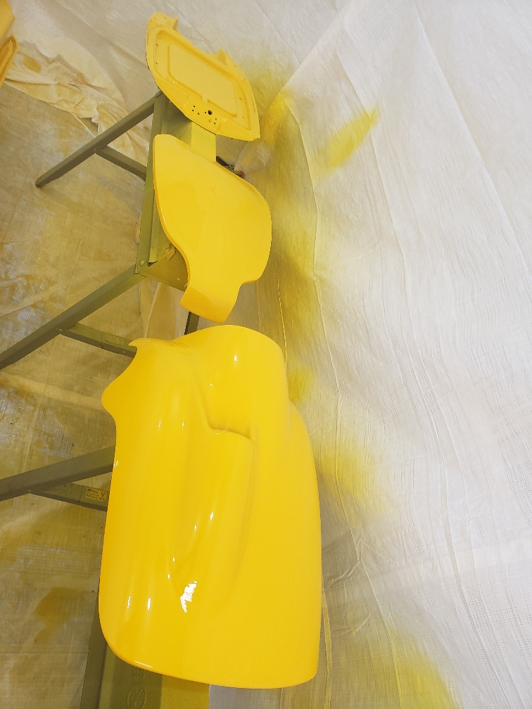

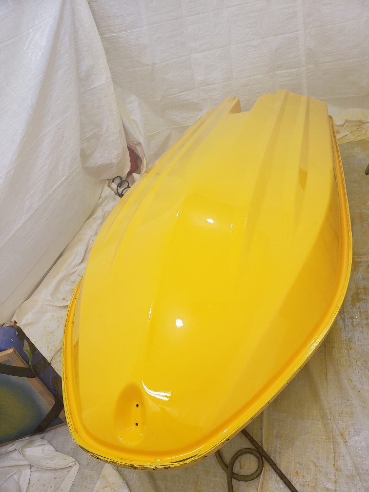

Lol it's all about my fan set up in there hahaHow come everything doesn't have a yellow tint from overspray ??? I know I know.... I'm not a good painter but I do get most of it on the panel I'm painting. LOL Looks GREAT !!
