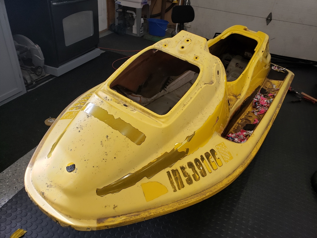

Got some more done over the weekend. Hull is ready to go now.
I took the ride plate off because it was broke. I have two other skis but I dont think I'll be able to get the ride plate off them with out it braking.....who has one? Lol
i took the foam out of the inside of the hull so i can do sponsons. do you guys think i should put some back in when im done? I think im going to gel coat/ paint the inside of the hull before i do the final install. i have the rx at the house now. ill take some pics of that at lunch.

Yes, you don't want it to sink so put back as much as you can.
I wouldn't bother painting the inside since it almost always starts to flake off after a few seasons.

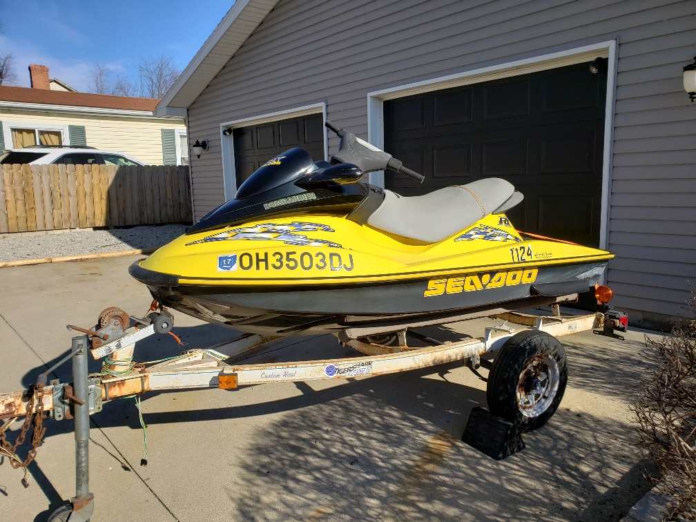

And now introducing the RX that has decided to give its life up to restore list 95 xp800 with a twist
