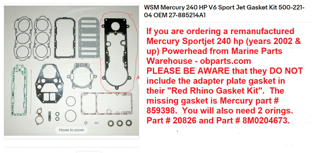

If you are ordering a remanufactured Mercury Sportjet 240 hp (years 2002 & up) Powerhead from Marine Parts Warehouse - obparts.com
PLEASE BE AWARE that they DO NOT include the adapter plate gasket in their "Red Rhino Gasket Kit".
The missing gasket is Mercury part # 859398. You will also need 2 orings - Part # 20826 and Part # 8M0204673.
Even though you give them your serial number and they say they are sending you all required gaskets….
Be aware and order the above in advance.
ASK me how I know 🤦🏼‍♀️

I have not tried them. SO FAR SO GOOD with the new powerhead longblock. We were just delayed a week on installation due to the adapter plate gasket not being included. We verified serial number and that all gaskets would be included prior to ordering.
ASK me how I know View attachment 64584
I ran into the same thing when I had my engine rebuilt in Homestead. Blame Mercury, not the builder. Mercury says all the gaskets are included, but adapter plate gasket was not included from Mercury.

There is a Mercury kit that includes the adapter plate gasket. There are 3 extra gaskets in the kit depending on what you have. It makes more sense than have 2 or 3 different gasket kits with 99% the same gaskets in them.
I doubt we’ll ever be doing this again but in the future I’ll know to ask exactly what gaskets are included instead of “Are all gaskets included?”.
