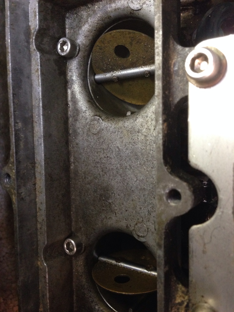

Also, could a choke valve on that carb that's 10% closed cause this? When I put the carbs back together, it seemed like they would both fully close and stay open correctly, but when I adjusted the low speed screws last time, I think the PTO carb's choke valve was slighty angled in when the choke was off.
Ahhh, I think I might have found the problem. The nut that keeps the choke linkage tight on the PTO carb came loose, causing the butterfly valve to act up. Thank god for easy fixes sometimes.
