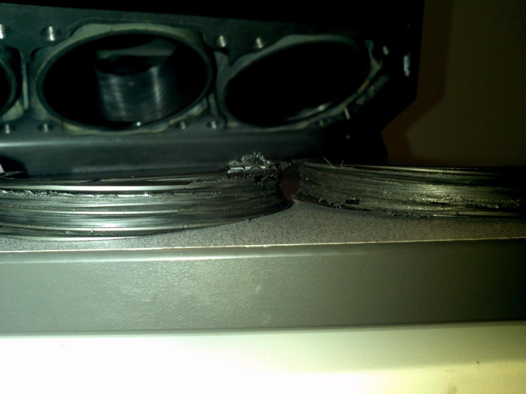

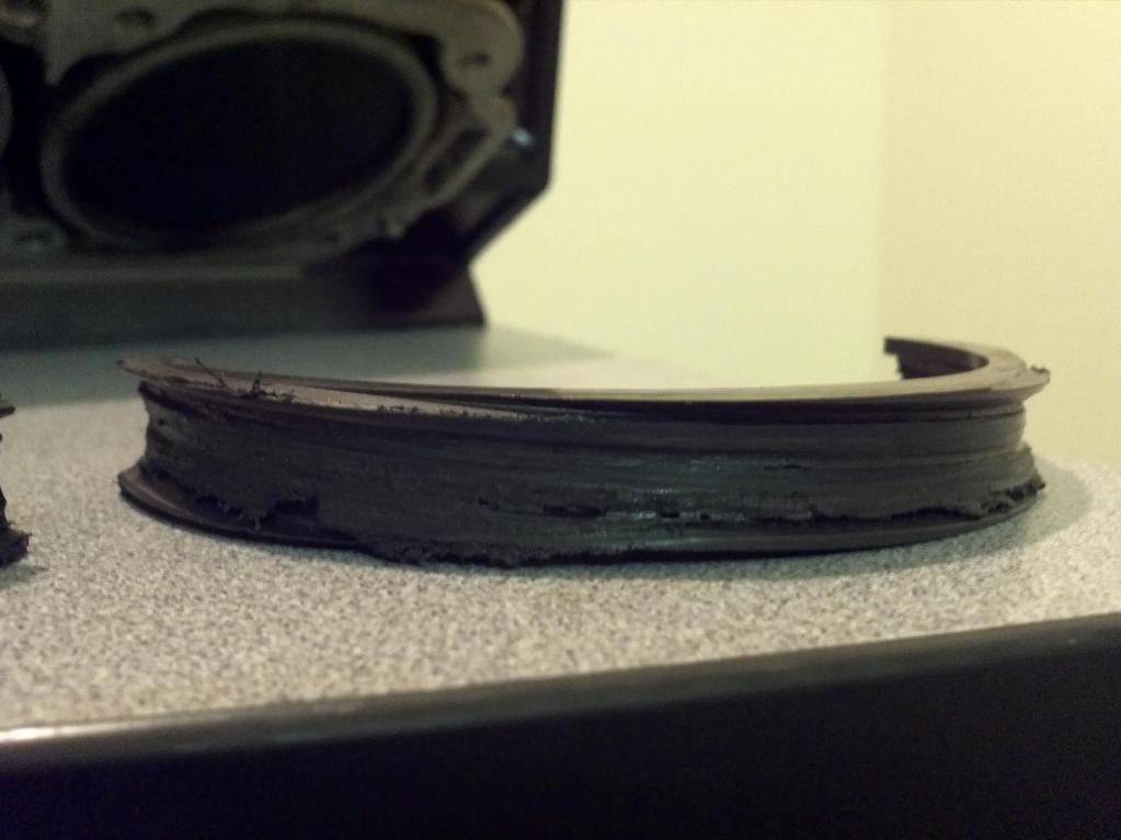

i heard that you want to put 1 gallon per 40 gallon or 50/1 and just run your oil out and premix it. but i heard at idle you only have to have like 100/1 so it will go thru quite a bit more oil, i just did a rebuild and replaced the worm gear on my 2000 240 merc engine and im gonna continue to use that now since it is new and better quality than the original supposedly... my old one wore out and caused engine failure.... not sure if your is electric or driven by crank. thats my input...(im currently 50/1 plus injection also for break in) Someone might come back with a more firm answer ive heard alot of people doing this.
p.s dont really know how many hours it took to tear it down this much.
