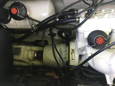

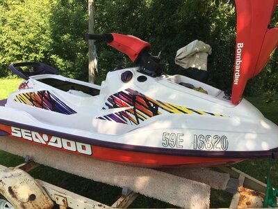

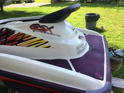

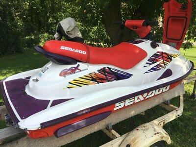

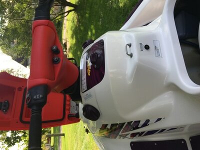

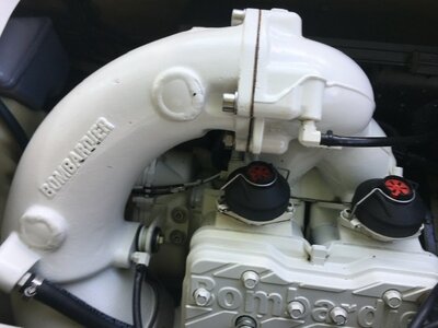

So this machine was definitely not a restoration but it is super clean, it has its little blemishes but it’s one of my favourites. When I bought it and got it home it had issues above 4500rpm, not knowing for sure I checked the coil, regulator/rectifier, cleaned the filters in carbs, changed the fuel lines. Still hesitated. With the help of Big Jake I got it working perfectly, was just really dirty rave valves. She is now running on XPS full synthetic so that shouldn’t be a problem again. Also changed the small oil lines, gave the whole machine a good rub down with Meguires 91, 49 then 45. If your proud of your old machine, post it here for everyone to see.
