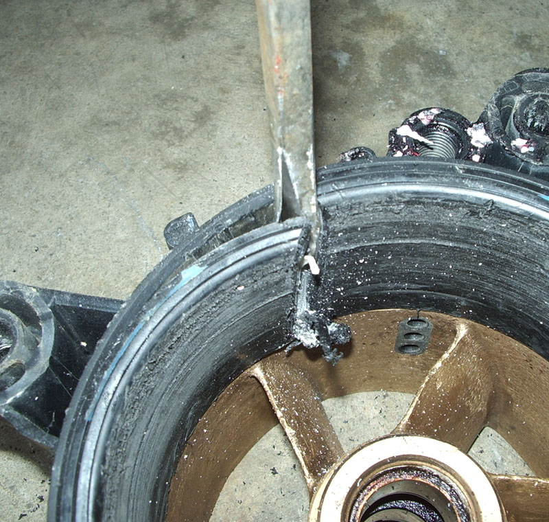

Boat is fixed.
Ends up the Jet holes were all scraped shut with plastic overlap when I sucked in a bunch of gravel and stones when I got pushed into the shore by a big malibu while trying to get my engine started
Needed to replace the Jet, so put in a new impeller and wear ring, cone while I was at it.
So to fix this cooling issue...:
Pulled the heads to clear the sand out of the jugs
Replaced tuned pipe and Exhaust manifold
Replaced Jet and assoicated components
not sure why Seadoos are so complicated and expensive to fix their cooling systems
