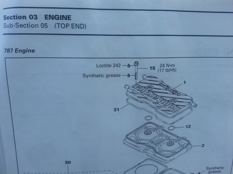

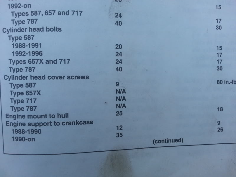

Clymers shows 30 for 787
Seadoo shows 17
Seadoo shows 17

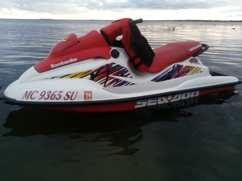

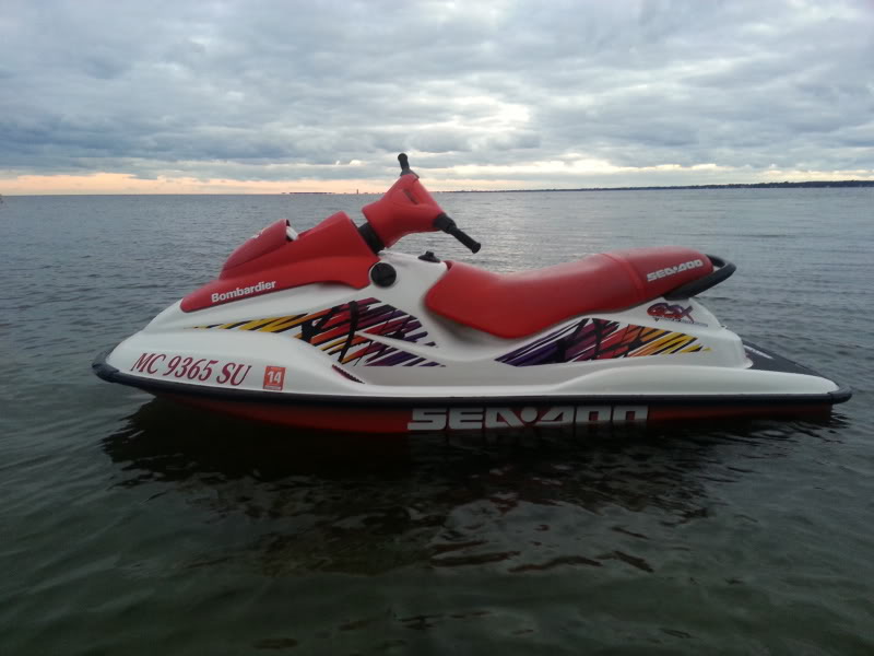

Got it all back togethor we are headed to the lake to water test now. We only have a little over an hr before dusk so not much time since it is a 20 minute ride and it just cooled off and rain is headed this way lol.
Are you in Lake Orion testing it?
My Clymer manual 1988-1996 also lists it as 30 ft lbs for a 787......good thing I downloaded a Seadoo manual off this site (actually 3 of them)
One other thing I noticed wrong in clymer... think it was the routing of the oil line from motor to tank...without looking it up again i think they pictured it from the top or side of motor instead of off the bottom.

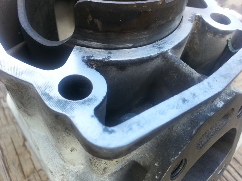

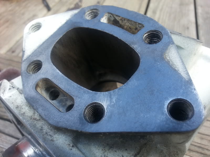

The mill makes that soooo nice! I have never easy outed mine. We just work up to just remove the screw(minor diameter). I have helicoiled a few of them after we had a drill bit snap in one then had that Wire EDM'd out. My XP has one or two that are helicoiled. I guess when Bombardier engineered these they left just enough space for a helicoil tap, they must have know it was going to be a problem down the road. I barely get any tap markings on OD of the cylinder wall, then I use the 16mm long inserts. Just for your reference they're available from Mcmaster.

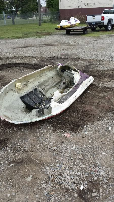

View attachment 22052View attachment 22053I need that big rubber piece that goes under the tank on the GSX you just crushed. Here is a couple pics of the one I will build up in a few months. You can tell from the hood and trim and Budwieser tour sponsorship that it was from 96. The engine mounts are for a 787 also.
That's sweet. Now, since you're scratch building it's time to step up the build quality. Build a show boat that rips no multi color engine and exhaust, I know they go fast, just refine the internal appearance. :beer:
