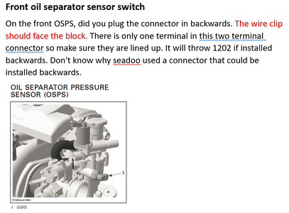

Hey guys I have a 2003 gtx 4 tec 1500cc non super, my issue is the oil warning lights coming on and puts the seadoo into a limp, oil level is fine good clean oil and brand new filter changed both front and rear sensors and still coming on when over 3000rpm I’m at a loss any advice? Something I’m missing it’s got great oil pressure
