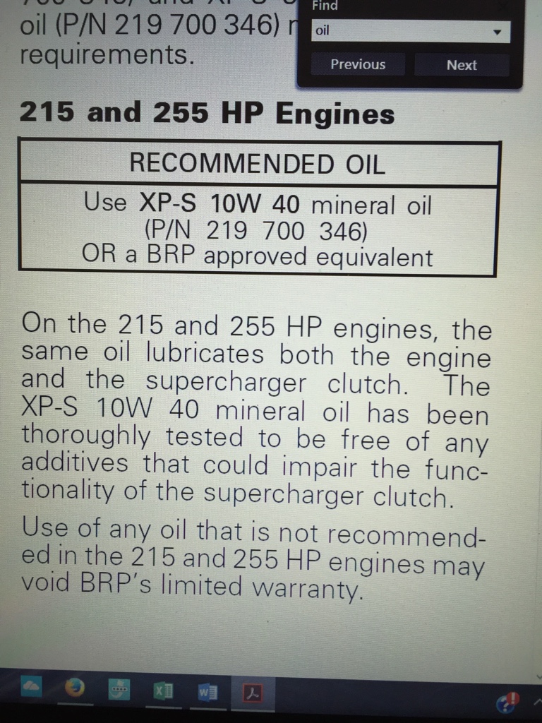

Here is what your manual states.
Do NOT use full synthetic, not good for the SC.
The part number in the top of the picture is NOT for your engine, it is for the 155 which can use synthetic,
