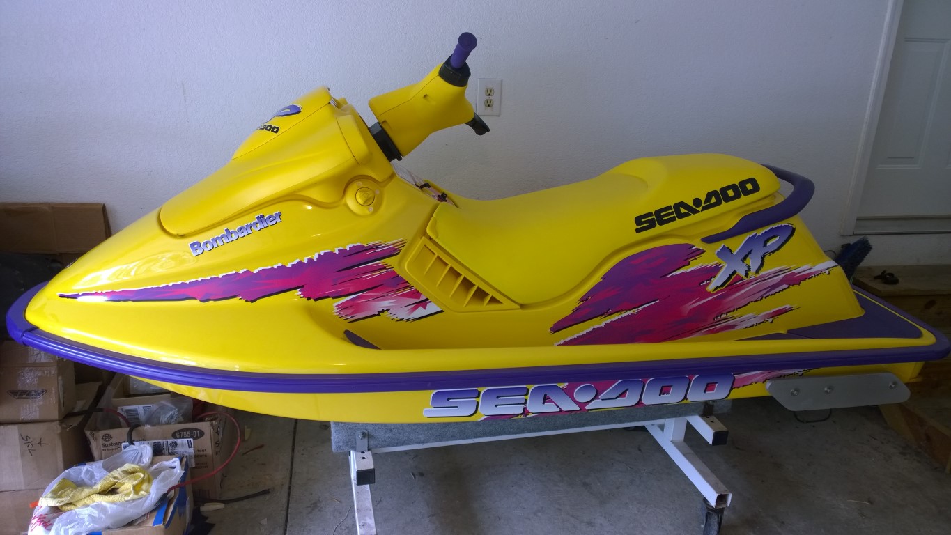

Really sexy boat, actually digging the purple.

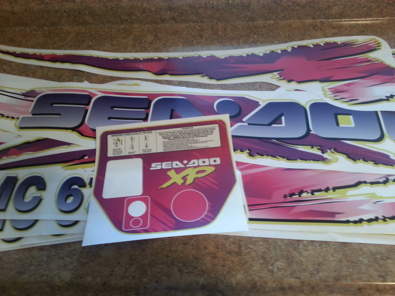

Over my lunch break I got the ski titled and registered, so now I need to order some new hull numbers. Anyone have recommendations on numbers? I have purchased from this guy on eBay in the past and been satisfied, but I am really digging the type/colors of numbers that are on it, since they match so well to the rest of the ski so well.
Pwcgraphics.com Made mine and they are fantastic. They will match yours perfectly. They have the same fade the letters in your graphic have and the font of the bombardier. You may want him to have them angled to match the contour of the hull, you cannot cut these and angle them yourself. They are one big decal they are not individual letters the yellow blends into the hull.
Contact Mike @ PWCGraphics.com i think. He goes by [MENTION=70010]RatFink[/MENTION] on here. [MENTION=51350]Jetskigoodies[/MENTION] got some custom ones on his 1996 seadoo xp resto from him and they turned out amazing, and i got some from him on my 1999 Spx resto as well and i love them.
Here is the link to the ones i put on mine http://www.seadooforum.com/showthre...adoo-Rehab-my-96-XP-Custom-Resto-Thread/page7
Looks awesome guys, I sent Mike a PM for some details on the hull numbers.
In the meantime, I did order some basic ones off eBay ($11), just in case it takes a while for the "good" ones to be made and come in! Thanks again for the recommendation, I forgot that Mike made registration numbers in addition to the reproduction factory sets. I'll be ordering at least one (probably two) sets of 1995 XP800 decals once they are ready and when I get my two 1995's ready for decals!

I am working on trying to find the correct arc to make the reg numbers match the contour. I can also add more space in between the numbers so they may be cut apart and arranged to fit.
Also - the 95XP800 repo kits are minutes from being finished. Just working with [MENTION=57920]racerxxx[/MENTION] on a couple of minor details.

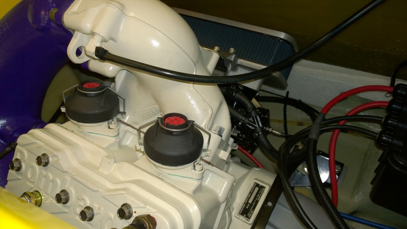

I have replaced all the fuel lines, not a single grey fuel line left on the ski! I also replaced the fuel filter and fuel selector. Drained the fuel tank (I'll see how my lawn mower runs on 15-year old premium, lol). I replaced the oil injection lines, oil filter and the lines going from the tank to the oil pump. I did not replace the larger 12mm oil lines going to the RV cavity, they appear to be in great shape. That will be done at a later date. I cleaned the oil tank and filled it with fresh XPS-II (It had the old blue XP-S oil in it). I serviced the RAVE's, this was the first time they had been done, I had to mess up the paint to remove them! They were a little dirty, but not nearly as bad as I've seen on other machines. They both moved freely up and down before I cleaned them up.
I also removed the Maryland registration stickers and hull numbers as well as a Maryland safety sticker on the back. There isn't any ghosting at all under the hull numbers! I think this is the first time I've seen a ski this old that hasn't had at least a tiny bit of ghosting when the numbers were! I also gave the ski a quick wash. Probably the first it's had in well over a decade. Cleans up nicely, even without any wax on it!
Here are a few pictures of the work:
Looks tight!
Don't burn that gas in the mower. I did from an old sled, probably a little older than 15 years old. I couldn't figure out why when I would make a hard turn down hill the exhaust would belch white smoke. This went on for 3 cuttings. Mind you, I would fog out the neighborhood. So I checked the oil, well, I found out why it would smoke. The crankcase was FULL to the top of the dipstick with gas and oil. I drivre back to my shop and changed the oil and drained the gas and went to fresh. I initially thought I blew a head gasket since my mower is liquid cooled, lol. No I didn't fill it, I only put a gallon in and I have almost a 5 gallon tank. I think that gallon went right to the crankcase.
Every time I see aftermarket FAs I'm going to think of the hell I had for 2 years trying to get my ski to run right.
Paint that sponson to match lol. This ski gives me a chubby
Good idea! The natural aluminum does appear out of place. Anyone have a good match of rattle can paint that will adhere well to aluminum (yellow, of course)? Maybe power coating would be the best option?
This is how I bought it, and haven't had it on the water yet, so I'm not sure how it runs. I do know that my 1998 GSXL also has F/A on it and it rips, no issues at all (well, fuel wise). I'm still trying to decide if I will keep the F/A's or if I'll install the stock airbox back on the ski.
As long as your plugs look good, and it rides great, then who cares. :)
