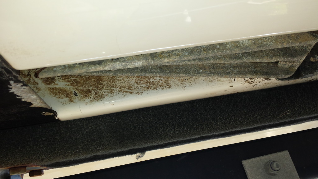

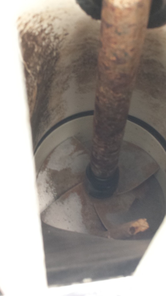

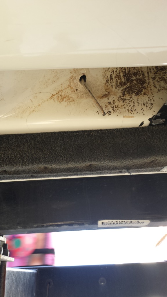

Well I brought the boat home from storage...mainly because the place i store it has been sold. I gotta do some work on it then find somewhere else to store it. Last time I had it out, I went through some really bad debris. I knew it probably wreaked havoc on the rings and impellers. So i decided to crawl under it real quick. Its not pretty. The rings and impellers don't worry me, thats expected. I found the right side intake grate hanging loose. It looks like the end of the cable snapped off. If you look on the parts diagram, it lists the end of the cable as a "joint" So I'm wondering if anybody has had an experience dealing with these cable ends. Looking at the good side, i don't see how that joint attaches to the end. I don't really feel like replacing the entire $200 cable. That looks like a PITA. So I am weighing my options. The port side grate also looks like some of the tines are bent...what options are out there for new grates? It looked like the bolts for the mounting bracket go through the hull and you would need to lift the engines to get to them...dont feel like doing that either, so all of this looks like it is going to suck. Here are some lousy pics i tried to take with my phone wedged under the boat.
End of the cable dangling free.
Port side...got a nice stick left over.

dammm looks almost as bad as mine was, I bet you have a big job coming up with that rusty drive shaft and all. Your boat came from salt water too right- down in the gulf ??? Depending what you plan to fix, you better start now, it will be a straight headache until you get all the old crap removed. The re-install is easy.
Finally got it all done. $800 bucks later and i should be good to go. Im at work today so i don't have pics. I pulled both pumps, both had some crappy rtv sealing them on. Im pretty sure there was air being sucked in there. Both shafts cleaned up nice, mostly just surface rust so i opted not to swap them out. The port side had a crack in one of the nozzles and it had a bolt stripped. So i replaced both wear rings, swapped SBT impellers. new port side nozzle. Instead of replacing that intake grate cable, i had a local shop tack weld the connection back to the metal shaft from the cable. Also replaced both fittings where those cables pass through the boat. Also found water leaking in form the scupper valve. Got it all sealed up and i think everything should be good for now. Hoping to get it out sometime next weekend.
Did you replace the carbon rings and hats? Sounds like you should be good to go. I finally got the exhaust back in mine for the 3rd time- found the leak in the far corner outlet.
No they actually looked ok, found lots of other places water was coming in, so i left em for now.
