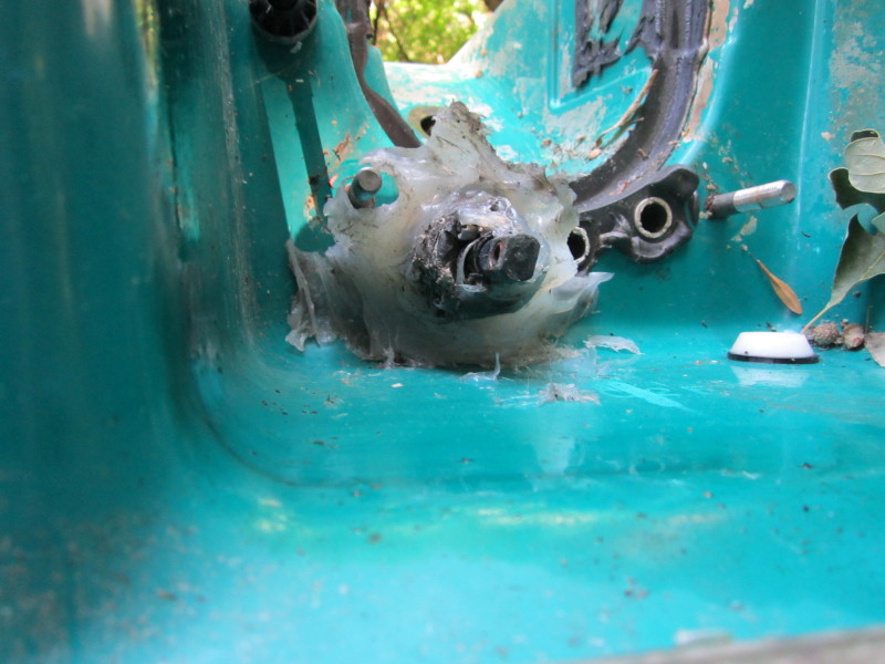

Heres a beautiful repair job I found on a parts machine a few months back....96SPX none the less! Just keep adding glue till she quits leaking...lol
