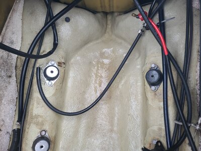

Hey guys, had a broken motor mount, so i took the motor out, cleaned out the hull, rebuilt the carb, and was about to put the engine back in l, but decided to remove the oil pump to bench test it since the oil lines were plugged and try to set up the engine with the oil injection again. While trying to put the oil pump back in, I dropped the split washer from the last 5mm Allen screw through the open port in the rotary valve on the PTO side.

I started taking the head bolts off, 6 out of 12 came off, the other 6 sheared off. Moved over to the exhaust manifold, 2 out of 8 came off, 5 started to strip, 1 sheared off. Moved over to the magneto side, 9 out of 12 came off, 3 sheared off, took the cover off and the flywheel was in immaculate condition. The bolts though had white stuff (salt maybe sand) the entire length of the threads, and some seemed slightly bent. I wonder if the engine had overheated at some point.

SabotageR1, i used a 1/2" drive extension ratchet, and to use a 14" cheater bar to get them to move, then tried a small DeWalt battery operated impact driver but that wasn't doing anything, then went back to the ratchets. As the bolts were coming up, small white powder was coming up the hole like crystallized salt or fine sand.
MikiDymac, i was thinking about the heat but was afraid since the head and cylinder housings seem to be some kind of cast aluminum alloy. If apply heat, I am assuming to heat the bolt and not the case, correct? Then I would think spray the PB Blaster and as it gets cool and contracts, hopefully the PB Blaster will creep inside the threads.
