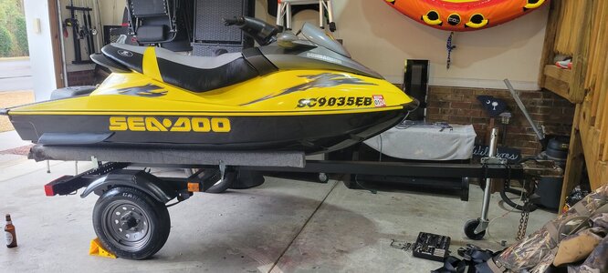

I ended up picking it up anyway. Needed a good clean and detail. Replaced the seat over, grips, top loader intake and installed blacktip decking. Took it out once so far and hit 61mph on GPS. So for $2000 with trailer, if it lasts 2 summers I'm good.

That's a DI? Check your oil pump hoses as best you can spend some time Looking around. Pull the plugs and see how they are burning and... check your compression. Run 93 octane fuel and full synthetic injection oil in that baby. Good Luck and have fun !!
Plugs, look good. All the hoses have been replaced. 93 octane yup, and Klotz synthetic oil. Haven't check compression yet.
Yes a DI
The one I had ran 58mph on the GPS. That was before I did the top end. Dunno if it went any faster after the work. LOL Th guy that bought it loved it. LOL

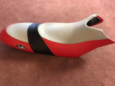

who makes that seat cover? How easy was install? Thanks
I'm not sure his seat is the exact same shape as my 2000 RX. My foam was very deteriorated and I was able to patch it and get a really nice shape. I've put a few seat covers on and I hate them more and more. You really have to know what you are doing especially to get things lined up properly and I surely don't know much about it. :D :D When the seat has a contour in the middle that has to be glued to get it to lay down properly. I brought this seat to a guy I use for upholstery to get the cover mounted. He did a great job as usual. His wife also said he had to use the steamer and it took two of them. LOL I'm not saying it can't be done and made to look nice but that stuff kicks my butt and I'm not doing it. :D :D As you can see this is a Black Tip seat cover. Good Luck !!

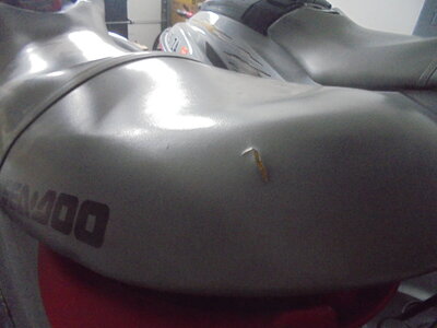

Thank you sir-looks good. Here are my seat covers-they aren't bad, just getting a little brittle at the back of them.

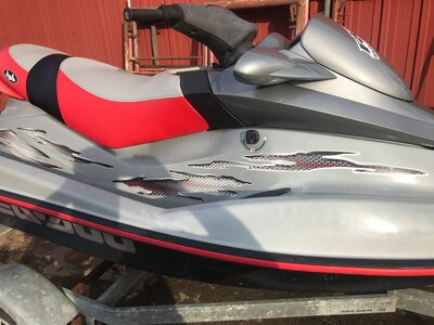

Looks like my 2000 RX. I just painted the whole dang thing... bottom too. Like to killed me. Looks nice now but I'm' waiting for graphics. This is my old picture. Ski had a duct tape seat before I replaced it. I think it was suppose to be gray but I wanted some "bling". :)

The gray didn't polish up like most gelcoats. It just got uglier so I had to do the bottom because it was damaged and not repaired properly. I sent PWCgraphics stencils/tracings of the graphics. He is slow but I'm sure he'll do a great job. Apparently he had never done graphics for that model.
Here is the thread with all my paint and repairs on the RX. 2000 RX Paint

I don't sit on them. Lol. Love the black metallic hood.

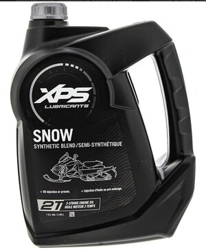

Question on oil for the RX DI. Wondering it this XPS 'Snow" 2T is ok to use. Says its good for Oil injection.

I wouldn't. You want the full synthetic oil designed for "direct injection". The (newer?) XPS Snow full synthetic says "direct injection" on the bottle and should be fine.
